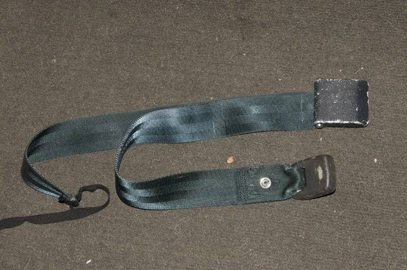

Is it easy - seat belt dying?

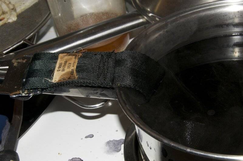

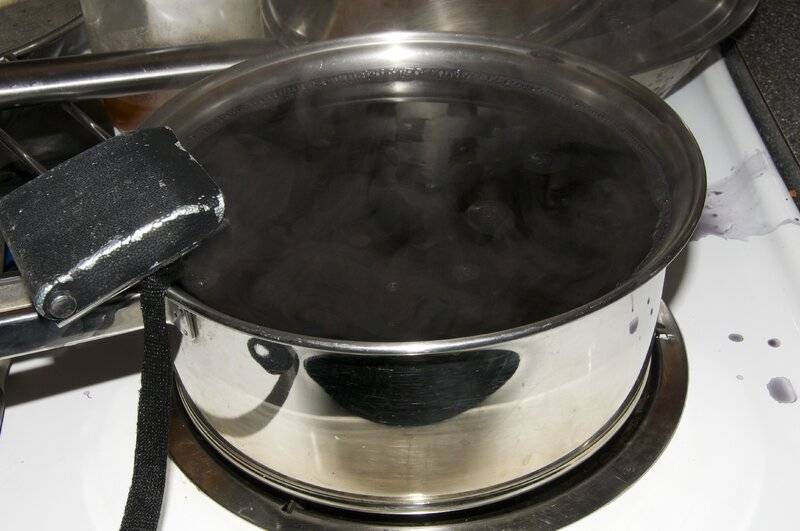

I agree with #4 about making sure they are clean. I put mine in laundry bags and washed them. The first question is if they are in good shape. If they are, keep them and use them. Mine are black but had faded so re-dyed them with Ritz for synthetics. Worked great. I tried to save the factory labels but that's not always possible. Richard O'Shields has the reproduction factory date coded labels if you need them.

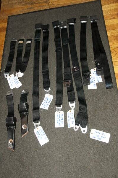

I labeled them so I know where they go.
After:

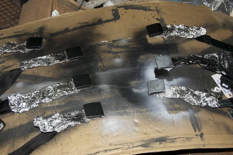

DON'T PAINT THEM you'll be sorry. I know people who did that and it will come off.
Then I cleaned and painted the buckles.
