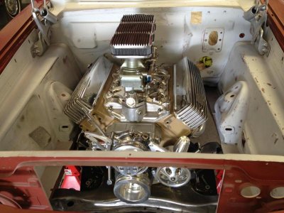

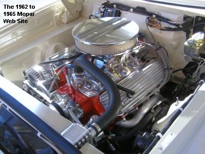

That engine started out as 277 cubic Inches, 180 HP. 1956,, I have one in my 56' Savoy. It is a superb engine, lots of low end torque. The 59' Dodge was the best, 325 cubic Inch and 255 HP 2 Barrel, and 295 with the four barrel. The Plymouth was a 318 57- up, and In 60' the Plymouth engine was adopted, 318, 230 HP. Chrysler decided to focus on the BB engine, and didn't want an engine smaller that would compete with the 361-383. A few two four 325's were made, and they were really quick. I hope to find a 59' 325 for my 56'. That would be fun!
What's not to like! tmm
