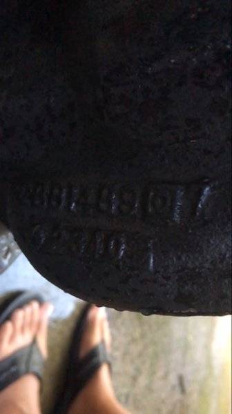

Is this a 489 case??
Thanks everyone. I just wanted to be sure before selling and I will be sure to use the term sure grip so I don’t offend by saying posi :)
Show us the gear side, that way we can tell if it is a clutch type or a cone type "posi".
I hope you know that just because it is a 489 case does not mean it is a sure grip.
It’s original to my 70 Roadrunner. Just putting a Dana 60 in. I will have to check it out. It is in basement drum to drum with leaf springs still attached.
89's will usually have a cone type SG unless someone swapped out the carrier in it and like mentioned already, not all rears came with a SG.
