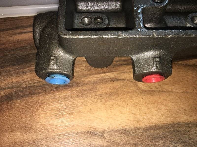

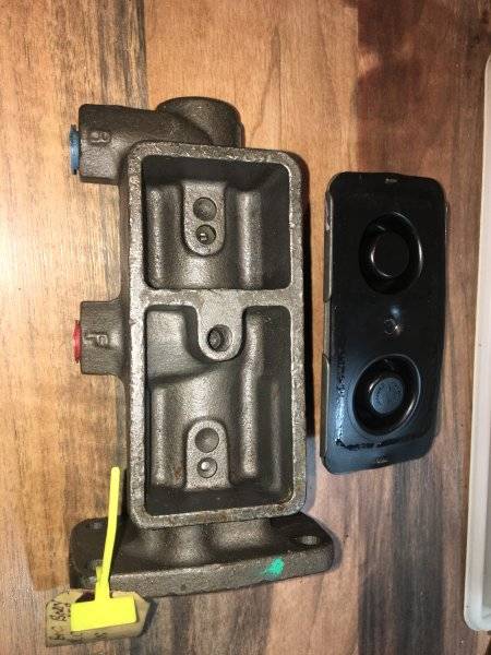

Hi everyone,
Mr. Fix it from the FCBO forum.

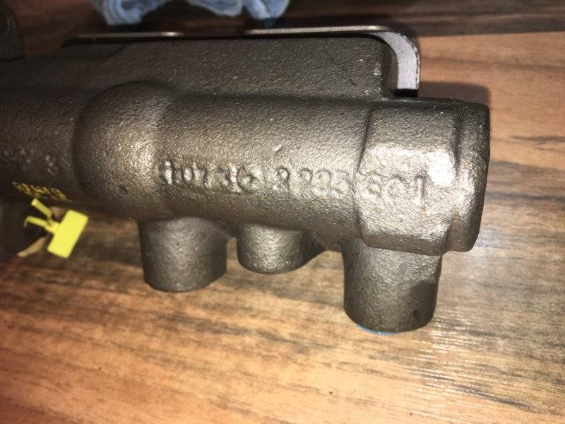

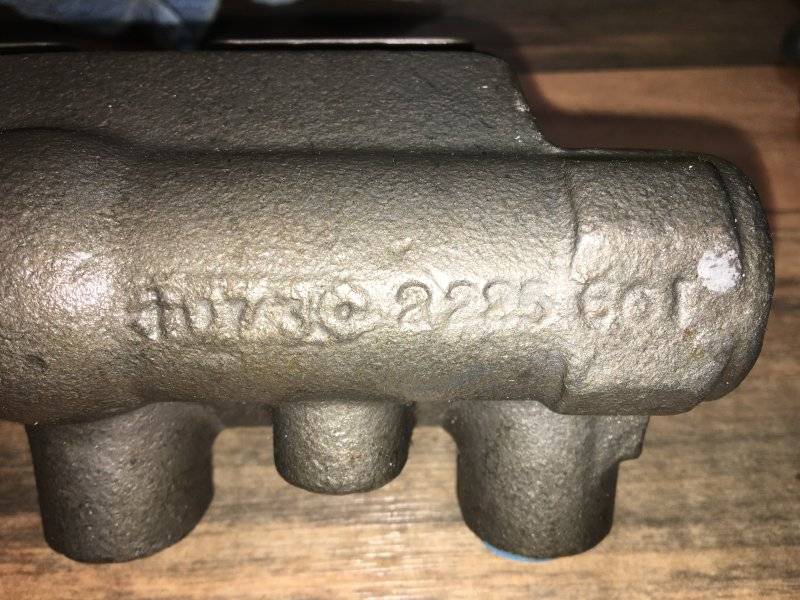

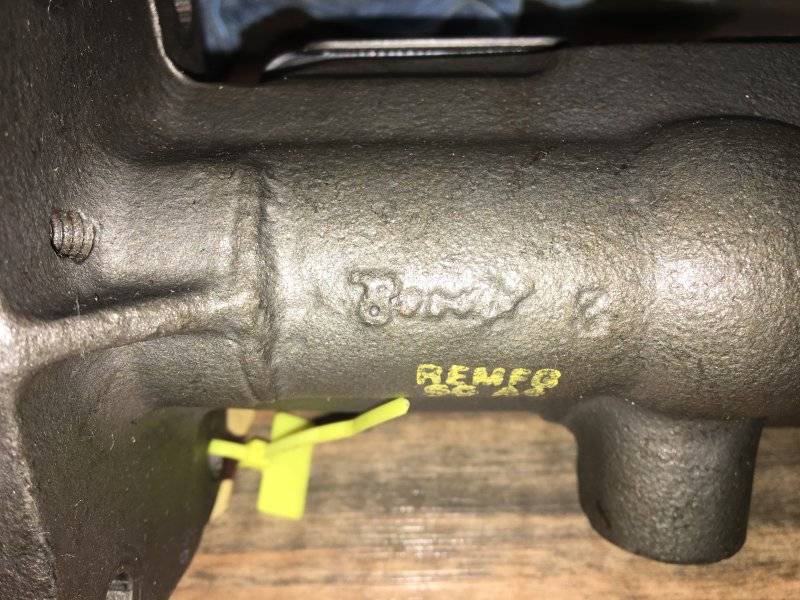

I have in my possession what is apparently a B/C body Drum Master cylinder that shows it's a Bendix 2225 601?
Can any of you brake gurus confirm this for me?
Have a look at the photos added here.
i do plan to sell this once I know what I have since I have no need for it.
TIA!:thumbsup:
Strange that I can't edit the posts here...

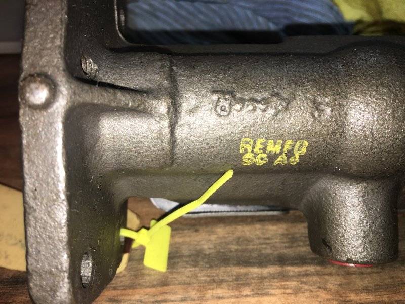

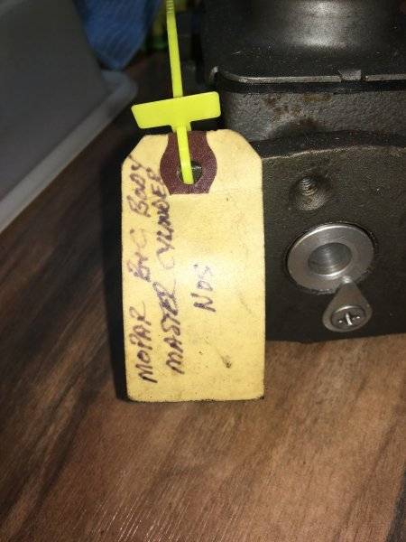

It shows it's NOS on the tag but it definitely shows it's a REMAN M/C.
I bench bled it about 1 year ago and that seemed to go well
Other than that, it's ready to install.
Looks like what I took off my 69 Charger. Rock Auto has them new for 34.00.
All car body styles with 4 wheel drum brakes, 1967 thru 1970

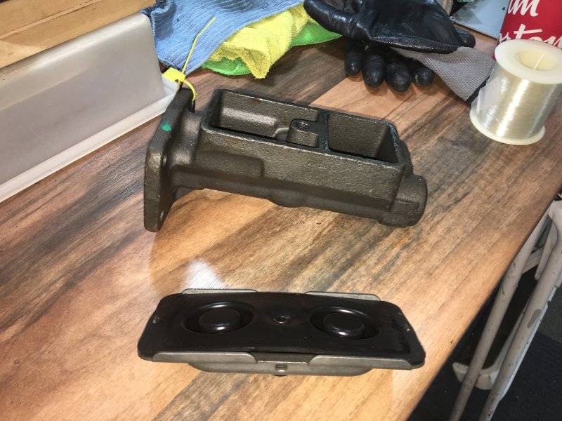

just wrong cap / lid to be OE correct
