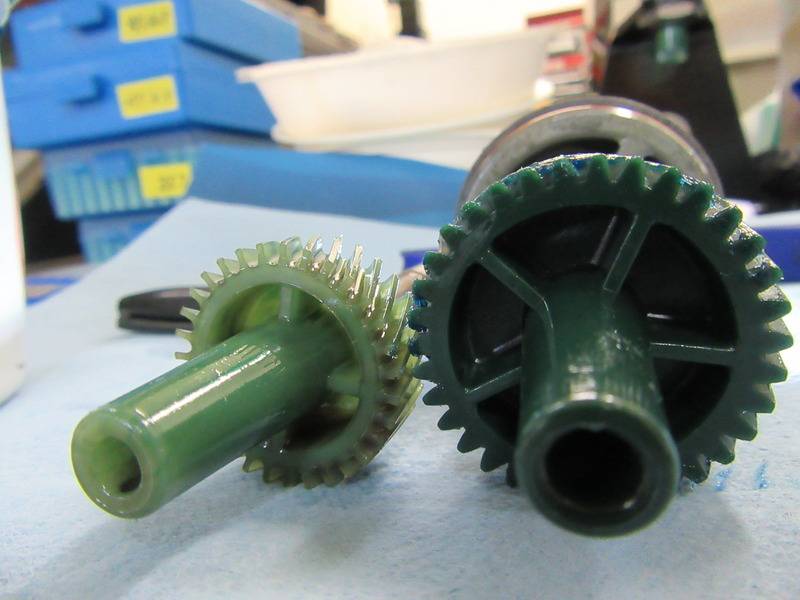

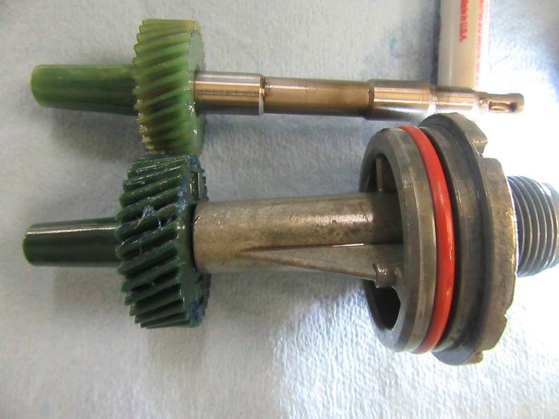

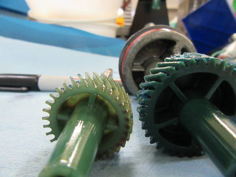

Since I installed a 3.55 rear my speedometer was way off with a 31 tooth gear. Ordered a 34 tooth gear (I have 15 inch tires/wheels) and was in the process of swapping them out when I noticed how much thicker the teeth are on the 34 tooth gear. Thought I better check before I try to install it.
Does this look like a good gear for an older Toqueflite? Or is it maybe a gear for a newer Torqueflite with different drive gear? This is a 68 transmission.

The new gear is completely different

Thanks - here are some better photos
Maybe that fits 518’s? When I had to buy one, the newest were early 70’s!
Correct me if I am wrong, but isn't the metal housing designed to be offset for the different ratios? If you look at the speedo cable end there should be 4 hash marks one of them needs to line up with mark on the tailshaft housing, I thought there might be a chart or numerics stamped onto housing that reflects the number of teeth that is on the gear you line up the hash marks and bolt it down
Ski is right, why not try the new gear w/o the adapter just by hand to see if teeth hit the output shaft correctly? Just a thought.

Yes - the housing is so marked and has to be clocked to the appropriate position to hit the spiral drive gear on the output.
I might try this - I have the car under a lift jacked up in the rear and I can barely scoot under it on a piece of cardboard so not sure if I can get a good view of the inside.

Well anyway - back to the thick toothed speedometer gear question? Anyone have a used 34 tooth gear for comparison?
I tried this today but between laying on the floor with my head barely clearing the exhaust pipes, trying to hold the gear in the opening with one hand, positioning the light with the other and trying to position my head and my bifocals so I could see - couldn't do it. So I went ahead and stuck the adaptor and gear in and indexed it for the tooth count and installed the clamp. Sticking a square head drive in the cable socket and it wouldn't turn so it's engaged in the output shaft threads.
