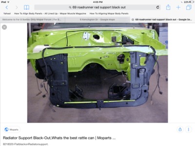

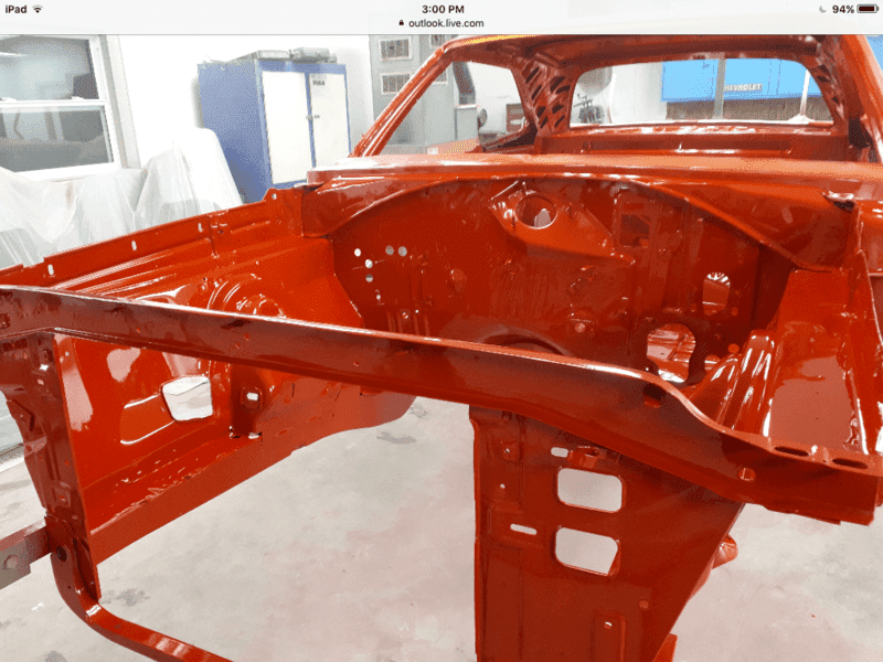

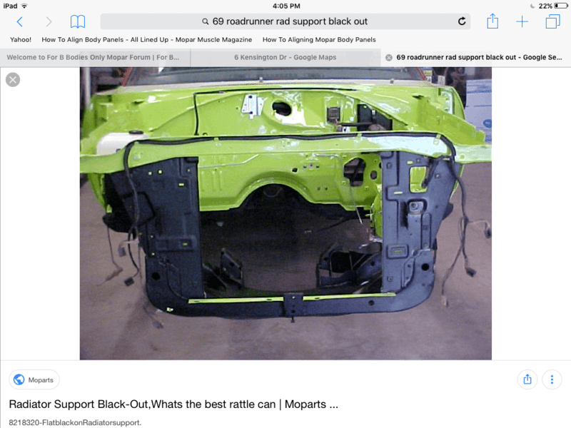

im getting ready to do the rad support blackout on my 69 roadrunner. Can someone tell me if the pic of the yellow car is correct. My car is the red pic. Is it correct to not black out the top support bar? Thanks in advance
View attachment 633674 View attachment 633675
The "correct" way is to spray it from below with no masking whatsoever. From what I've seen it might also help if you did it with your eyes closed! Personally, I would do it like the green car. I couldn't stand having it hap-hazard like the factory did it.
Black but the factory wasn't too concerned with neatness, they just sprayed what showed flat black

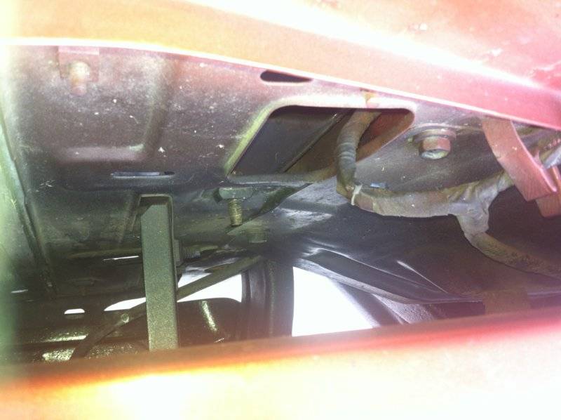

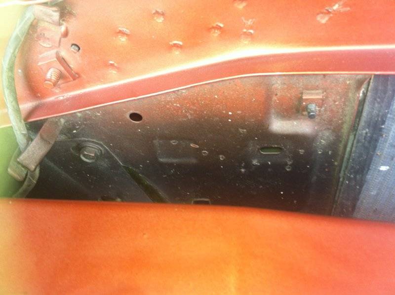

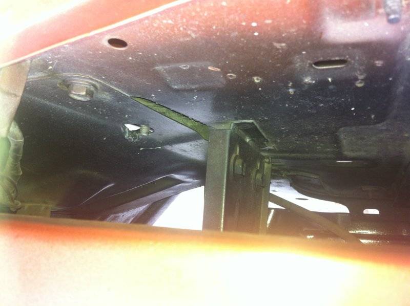

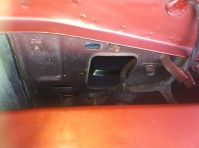

here is some pictures of my factory painted rad support on my 1970 Sport Satellite
This is interesting. I had been meaning to do mine and was sorry I didn't do it when I had the grill out when I swapped cams, but now that I know neatness doesn't count I might just have at it.
i have seen the top bar hit with a very light over spray mist
the yellow/green car was done way too neatly
look closely at moe's pics and see how the top of the side panels
just have just a mist on them as you look towards the top of the panels just below the top bar.

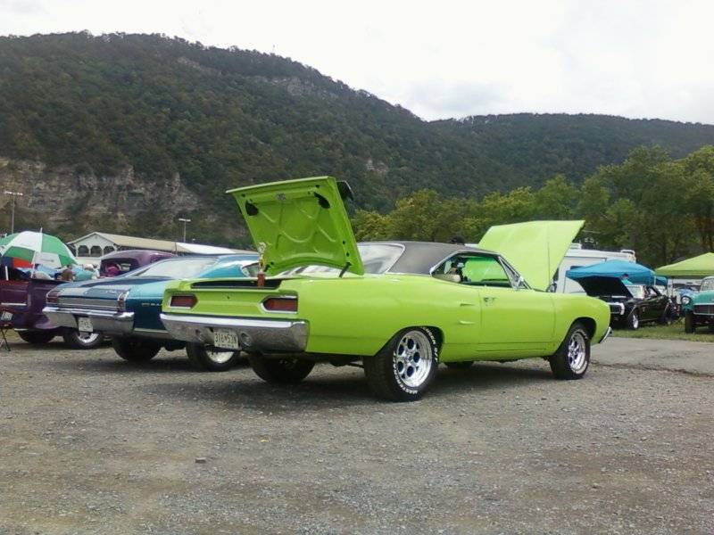

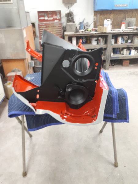

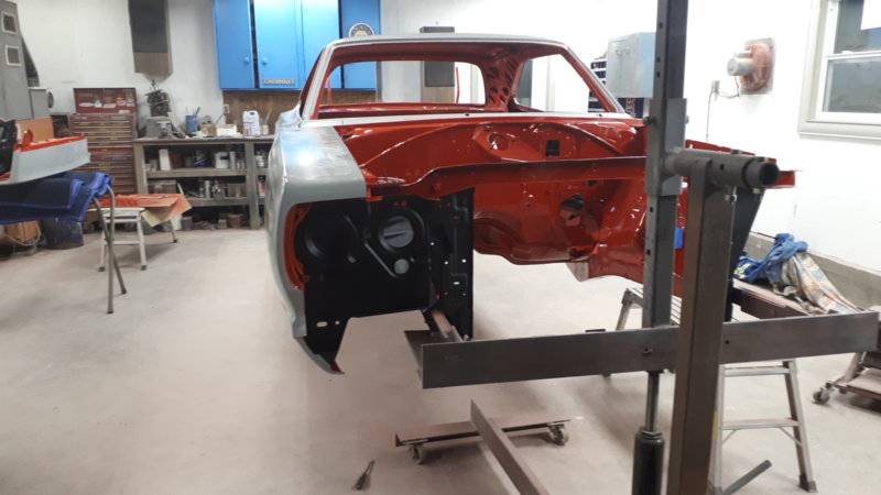

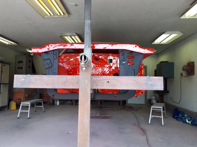

I decided to try and keep mine neater than the factory
