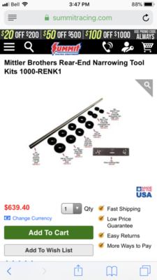

You need this tool to keep everything in line. I did a truck Diff because I’m doing a 4 link so I don’t care about the pinion snubber. I stumbled on this guy by accident who does DANA 60’S for mopars up here in Alberta Canada. The truck Diff to me isn’t that much cheaper. I bought all new stuff for mine from DR.Diff. That guy is a good guy! Call him if you need help. He also sells the parts to a Dana very reasonable. I was 100% Satisfied with him.
