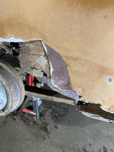

Is this old body filler?
kliv555
2:13 PM
Nov 16, 2022
11
8
MB, Canada
So I am beginning to sand down the paint to replace a quarter panel, it appears to be a layer of paint, then a hardened brown layer, then the steel underneath this. It doesn’t appear to be the case in other parts of the car. Thanks for any input.
Looks like it, if you pry it out in big chunks then it is for sure
Any old news papers in the back ? Surprise to see no chicken wire.

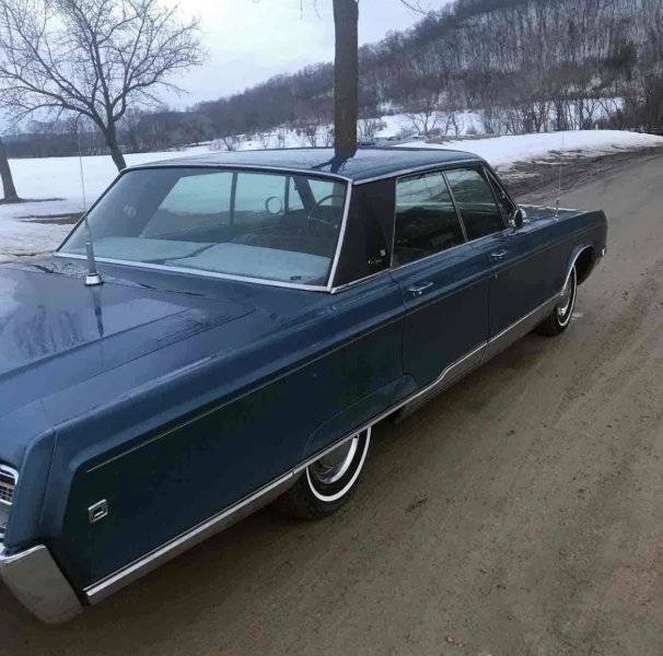

I had a ‘68 New Yorker that came standard with vinyl sail panels. The roof was painted, but vinyl where they would have had to make it look pretty. :D The 4 door H/T. You can see what the factory did here.
