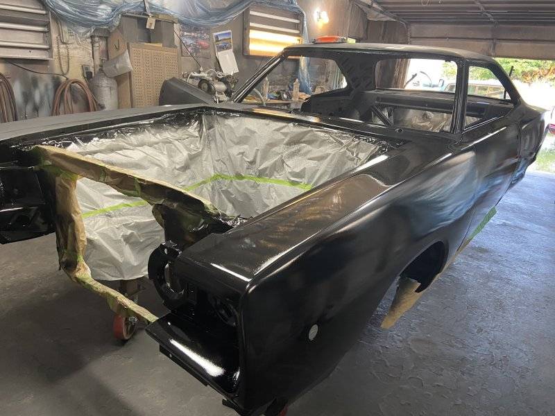

I would like to ask the more knowledgeable people if they think this is possible or is there too much interference? I’m building a 68 Coronet 383 4spd and want to incorporate a/c (sanden comp mounted below alt), power brakes, power steering and headers. Will it all fit? Thanks

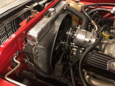

I have all that in my red '70 Charger with a 440 based 495.

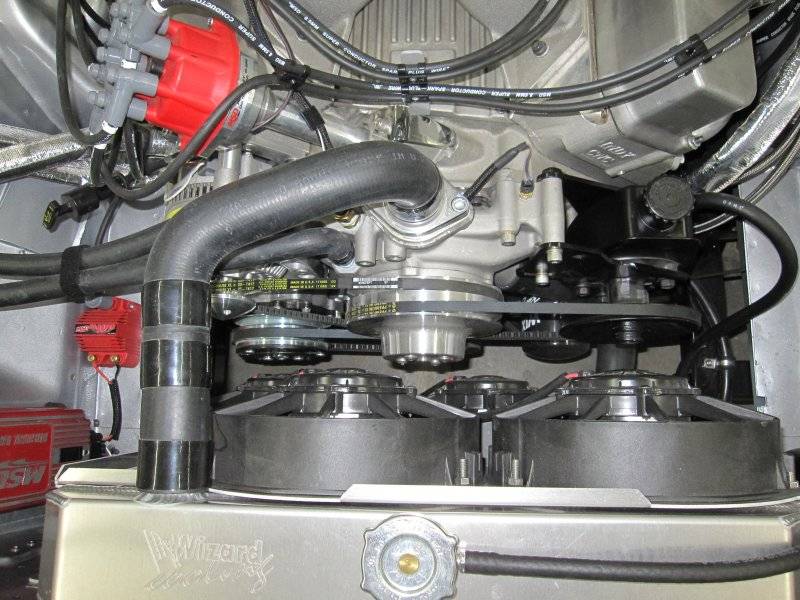

Radiator fan clearance can be an issue if adding pulleys that move accessories or the belts forward.

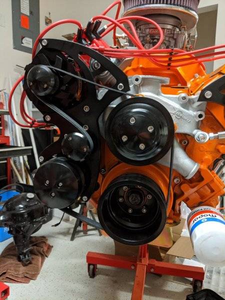

I have the Billet Specialties trutrac Serpentine drive system on the 440 in the '69 Coronet and using electric cooling fans as there is not much room for a mechanical fan.

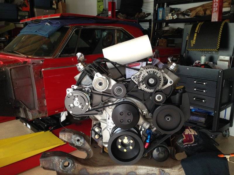

I'm using the setup from SD Concepts. Not sure if he's still making them though.

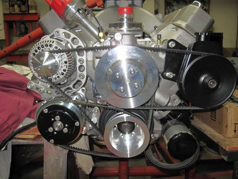

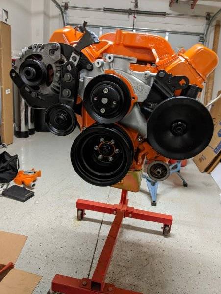

I went with the March serpentine system. Fits in my 63 440 with room for dual electric fans.
Thanks for all the replies, Just wanted to make sure before I invest in parts and start putting it together. Final paint just about done and can soon start assembly.
