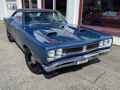

Hey guys. I came across a 1969 Dodge Coronet 500 with a 383 engine matted to a 4 speed manual Hurst shifter. The car is also equiped with a ram charger hood. VIN #WP23H9G280924.
Did they come equiped like this from the factory?
I don't believe the Coronet 500 could be ordered with a ramcharger hood...but stranger things have been found sneaking through the cracks. But the 383/4bbl and 4spd absolutely.

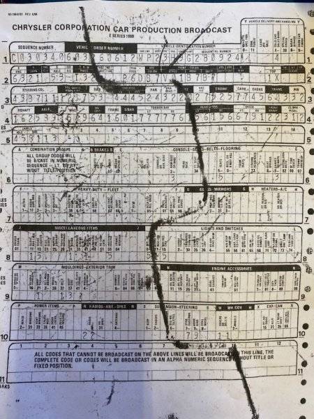

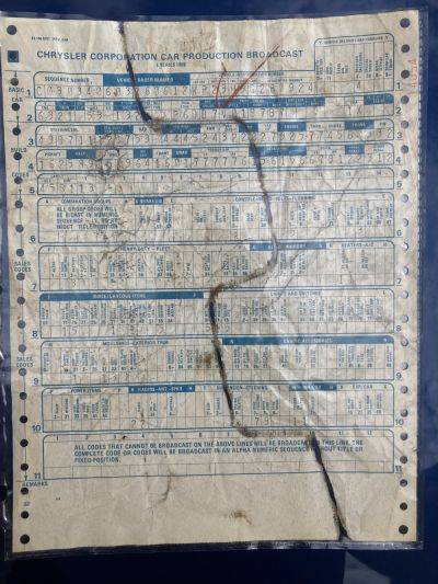

That build sheet looks like someone crumpled it up and flattened it to try and make it look older then it really is...probably a reproduction.

How about a larger, more clear scan of that build sheet for starters?
Cmon you guys....it clearly has the correct seat spring imprint.... those are very difficult to fake. :poke:
Yeah, I know. I've been slow to post for sure. As to the quality of the build sheet, this is the only one I have.
I saw that car a few days ago. It is very nice, but if originality is important you best look it over quite carefully:
H in the VIN = 383 4bbl at least! Should have D21 on the fender tag bottom line if an original 4 speed car. N96 on the tag would indicate ram-charger.
If it really was equipped this way, It would be unusual and probably worth the dough.
Does the car have a fender tag? I'm no expert but that build sheet for some reason screams fake/reproduction to me.
Check for vin on the motor, along the bottom by the oil pan, and also the 4-speed. It should be on both. The body numbers should match too. For that much bread I’d get a inspection and appraisal done.
