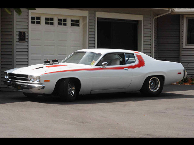

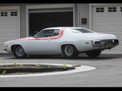

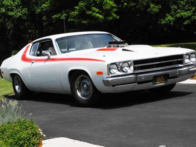

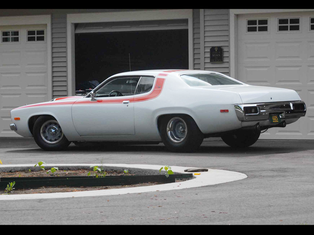

I am running 285/70r15 on the rear of my RR. in order to make that fit correctly I put an "A" body rear end in it and used spring re locators for an "E" body (offset hangers). I have these mounted on 10"rims and a 4" or 4.5" back space (cant remember which) from wheel vintiques. I wanted the tire to tuck into the body. the measurements on my tires are between 11-12" wide, approx 30" tall. In order to get the correct rim tire combo for your car yo will need to do the measurements. Remember that the "285" is the width in MM. to convert divide by 25.4 and you will get inches. the "70" is the height, 70% of the width, this equals the side wall height. that that number times 2 plus you rim diameter and there is you over all diameter.
So. with out putting a straight edge on you axle (where the wheel bolts to) and measuring your wheel well room room, you will not know what your car can handle. now it doesn't make any difference if you want the tires to stick out the side of the car, then you can go as wide as you want with the standard mopar wheel back spacing.
