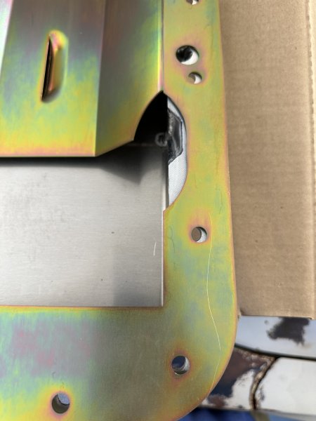

Has anyone else had issues with 440 Source oil pans? I have an 8 qt fabricated aluminum pan, and am having some figment issues.
Firstly, the holes for the pan bolts/studs don’t line up well. They say they are all test fitted prior to shipping and that they fit, but that they could use filing or grinding to fit easier.

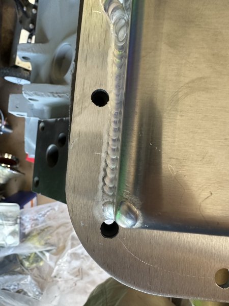

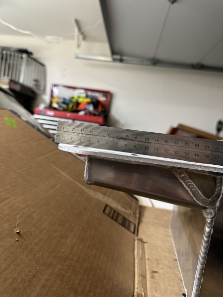

Secondly, the pan is not flat. The rail where it mounts to the block is warped. This might have created part of the first issue. It obviously got too hot while tig welding. Their customer service has said this is “normal”, and that a fabricated pan that is similar and totally straight normally runs $800 or so. It’s clearly off by 1/4” on one end, or maybe it has a high center and 1/8” gap on each end. Either way, the straight edge shows it’s not straight. They say it pulls flat when torqued, I have not verified yet because the holes don’t line up, although they said it fit prior to shipping.
There is also some slag around the drain plug which will I will end up grinding down.

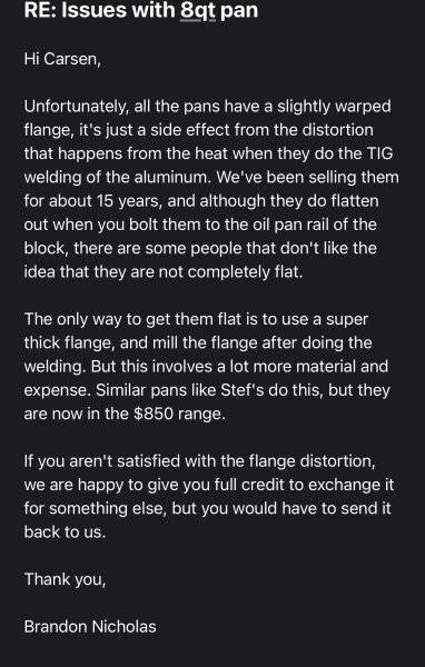

I spoke with them about the issues, they did offer an exchange with no restocking fee but it is store credit with me eating $40-50 in shipping.
Am I that out of line for thinking a moroso pan for $70 more would likely have none of these issues? They claim the only way to have it straight is to mill it after welding it, since that warps the rim.

Nope!!! I would return that pile of crap. Weld bead too close to bolt holes. Bolt holes out of alignment. Warping like that should not happen.

My guess is that their policy is once you mount it you own it... so don't. They are obviously reading off the script about them test fitting it.

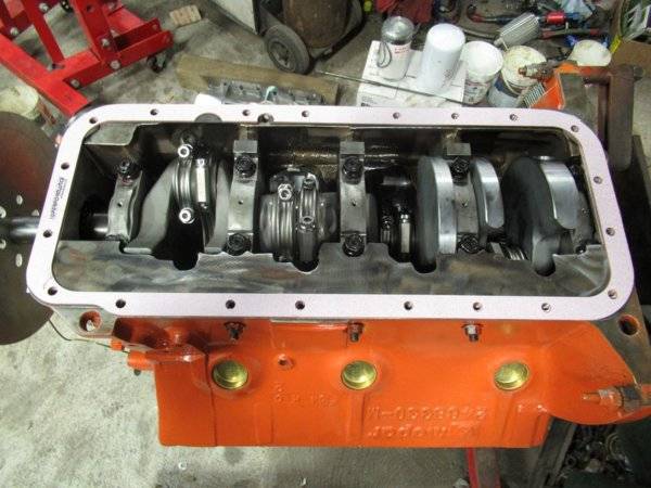

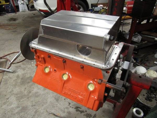

I had hole issues with my Charlies pan. I also had hole issues with my I J crank scraper. Not sure why. It's a simple bolt pattern. That being said it wasn't the end of the world. Opened up the holes and went about installing the parts. As far as being warped. I'd bolt it down. Bet it flatens right out. The good thing about a BB mopar is the block itself is flat. So it's not hard to seal. Use Ultra Grey RTV and you could take the bolts out once it drys. The only reason I use a gasket is so it'll come off easy. Mines been welded up from wheel stands, rod exiting the bottom and side. I'm sure it's warped some. However bolted on it doesn't leak a drop. Price a Billet fab or Steffs pan. $$0 source is a bargin. Do check any fabbed pan for leaks. Fill it and let it set a day on dry paper towel.

I have been speaking with them. In all fairness, the bolt holes aren’t as far off as the photo suggests, but you would have to force it on and it’s going to make some aluminum shards which I don’t want going into my motor. However, the beads are close to several of the holes and the pan is definitely warped.
