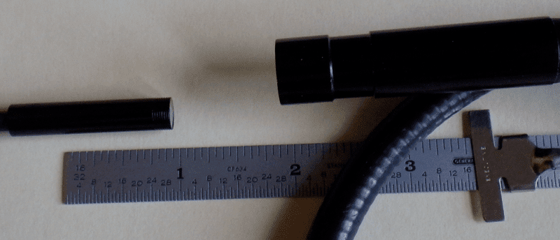

I can't think of any. Maybe you could see something with a mini cam.
