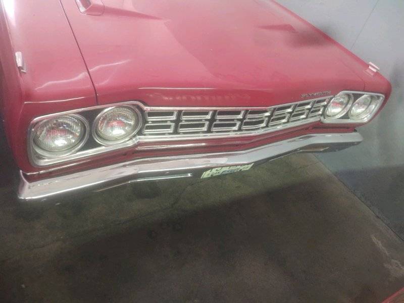

And here's a pic from the car my 'new' 68 grill came off of.
This particular car was a GTX that the owner wanted to have a 'GTX specific grill' on ....which is why he sold it to me. Also, to my knowledge, you can't buy a 1968 grill from any aftermarket manufacturer (Classic Industries, etc..). Why? I have no idea. At this time (2022), you need to get it from a junkyard or recycler. I believe the 1969 grill can be ordered from a catalog.

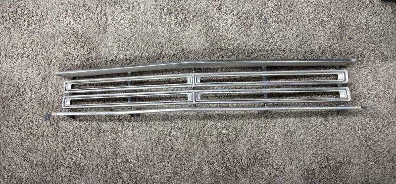

Here's what the 68 headlight bezels and center section look like.

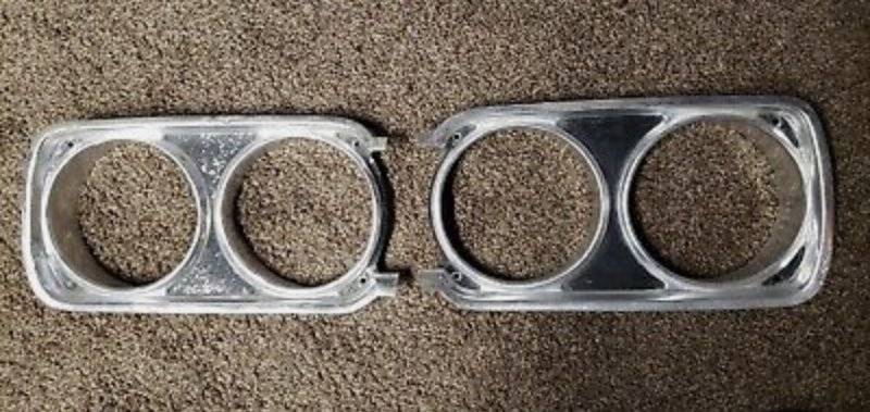

And here's what the 69 headlight bezels and center section look like.
Lastly....if you scroll up and compare the two pictures of 68 grills. You'll see that one's center section is shiny chrome and the others is painted a flat grey color on the little rectangles. I BELIEVE that the roadrunner's had the flat grey color and the chrome was used on the Satellites. I'm sure someone will chime in with more info on this and how I'm not quite right (but you get the picture :p )

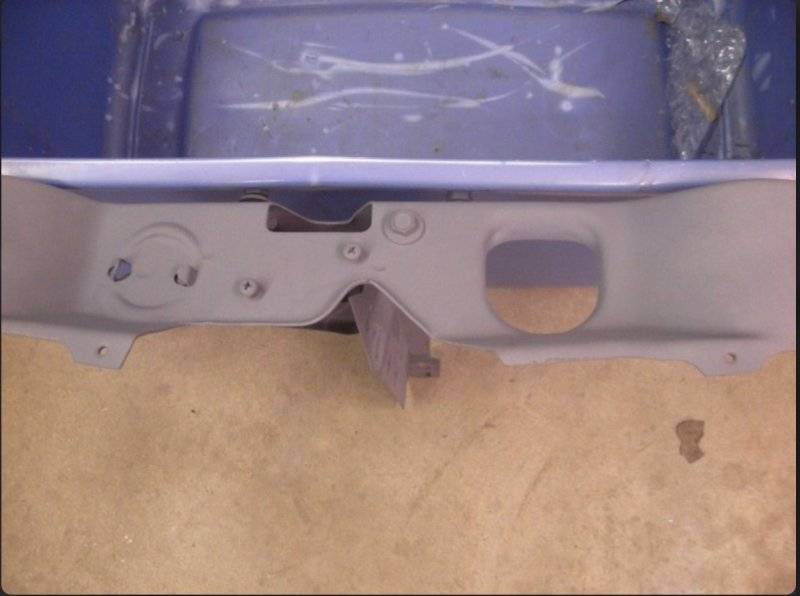

I found some online pics of sandblasted examples of upper cross bars on the 2 years. They're zoomed in so you can see the difference in the square hole and the lack of metal on the front of the 68 upper cross bar in comparison. Here's the 69 like what's picture above on my car.
And here's the upper cross bar from 1968. Notice that it has less metal on the front of it, the squarish hole is more rounded in the front, but the two mount holes that hold the latch release are in the same place.
Here I used some else's pic (probably from this forum) and drew arrows to indicate the upper cross bar on a 'finished' car. Also note that the 68 grill has 6 front mounting screws instead of 4 on the 69.
And finally after finding the upper cross bar for my project, I took a comparison picture. Funny thing was that it was also sunfire yellow (and rust).

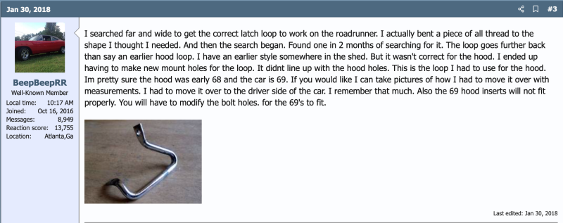

Next we move onto the "Hood Latch Safety Catch"!!! It's this guy.
Depending on which hood you have or how your 'safety catch' is bent, it probably won't line up with the latch receiver. It's also easiest to figure this part out BEFORE you mount the grill center section in place so you can SEE it line up. If I were a lucky man, I'd find one from a junkyard that lines up well. Also, I read a thread on this forum that showed you can redrill the mounting holes over 5/8" towards the driver side to make the original one work. Here's a comment from BeepBeepRR on what I'm talking about.
I ended up taking a piece of steel rod (either 5/16" or 3/8") and spent some time with a torch and hammer to make my own. I flattened out the ends and drilled a mounting hole. I ain't pretty, but it works.
Now you can spend a little time adjusting the hood latch receiver so it's lined up right, your hood gaps are even and the height of the hood is flat when closed.

Note that the chrome rings surrounding the headlight glass is round in 68 and square in 69. The black paint detail is also a little different.
You can also see that there are screw holes in 4 spots on each bezel (2 inner towards grill, 2 outer towards fender edge). The 2 on the inner side line up (and attach) with the center section of the grill, the two on the outer screw into a bracket welded inside the lip of the fender headlight indentation. BUT THEY AREN'T THE SAME ON 68 AND 69 FENDERS!! This is one 'modification' you'll have to make if you have the wrong fenders for the grill you're using (like me). And before you say it.....Yes I know my fender side marker lights are still square and I'm going to have to change that out too. Yeah.. Yeah...I know. That's for another day.

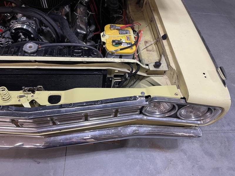

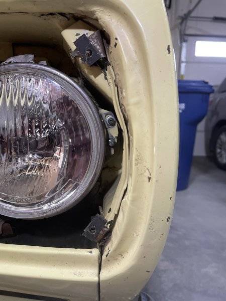

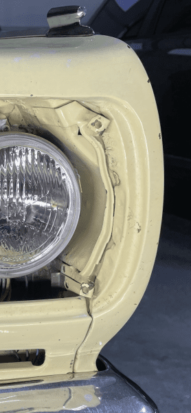

Back to the fender headlight indentation with bracket. Here's my left (DS) side assembly with the 2 painted tabs on the bracket.
You can't see exactly what I'm pointing at? How's this?
There are U-type clips that the screws thread into and sit over the tabs and are centered on the tab 'hole'. I ended up using some U-clips from a glove box project that worked great from me. I got them from Classic Industries and took a pic.

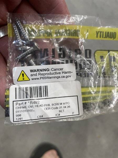

Part #11429 67-72 GM Glove Box Clips
While we're at it, I also used some chrome headed screws from Classic Industries and here's a pic of them.
Part #R492 through OER. I used 8 of these for the both sides of the headlight bezels. Paint them black of you want them to blend into the bezels.
Alright.....now pay attention! Keep these pictures in mind and scroll to the next post! You have to 'modify' the tabs on those little fender brackets. And by 'modify', I mean get your needle nose pliers, needle nose vise grips, a little pry bar, a hammer, and likely a BFH ...and beat them to where they need to be.

So here's the 69 fender pocket with bracket/tabs again.
And again.
Now use your tools and bend the little tabs forward so they're sticking out straight. Then clamp onto them further back with a needle nose vise grips and rebend them back in so the new bezels can sit further into the fender pocket. You may have to bend them angled up and down and Beat them in and out to get them to sit right. Keep checking your progress by holding your 'new' 68 headlight bezel in place. I had to use some tin snips to trim off the extra length of metal to clear the bends of the headlight bezels themselves. Check the gaps between the headlight bezel and the sheet metal above and below the bezel as well as how far the bezel sits in the pocket. You'll want to have the 2 inner screws attached to the mounted center section to help with alignment. Once you get it right (or close enough) the tabs may look like this.
S4*t!.... I forgot about your crappy vision and bifocals. Maybe this??
I know it ain't pretty, but it works. You can see that after I got the tabs where I needed them (by placing the bezels over the modified metal tabs .... aligning my gaps.... then marking the future hole with a sharpee) I drilled some holes and placed the U-type clips over the 'modified' tabs.

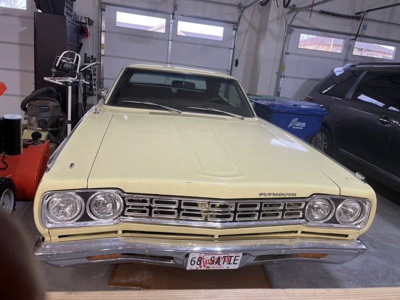

Here's what I started with (1969 grill version):
And here's the finished product, a 1968 Plymouth Satellite with a 68 grill and headlight bezels.
