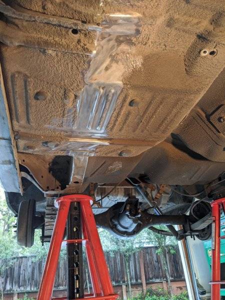

- Sub Frame work: Putting in US Car Tool sub-frame connectors now - holy **** grinding out the damn undercoating is the filthiest thing I may have ever done. I have black sand in every crevice. Also putting in US Car Tool torque boxes front and back - considering radiator support too, but undecided.

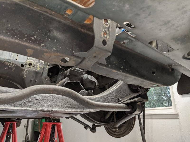

Thank you sir! Quick question - the radiator support looks good and it makes sense that it almost finishes the "box" of the frame along with the subframe connectors - but what did you do about the clip attached to the stock rad support pictured -- I'm pretty reluctant to cut that guy off....did you cut the US Cart Tool support around it?
Thanks again!
Thanks again!
I did remove the bracket. It wasn’t a big deal, just a few spot welds to cut and plug weld it back in. It’s pretty easy to get it fit back in place, I’m sure you won’t have a problem.
welcome from Pa. like those stands, where did you find them???
I didn't cut mine off. Not sure but I think usct recommends leaving the stock one on and overlap/weld it with their's. That's what I did.... Looks like you have later model door handles, kinda cool! Nice shop also!!

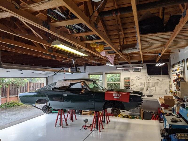

Welcome from Arizona! We love our mopars too. Another question is how did you get your car so high to use those stands. thanks

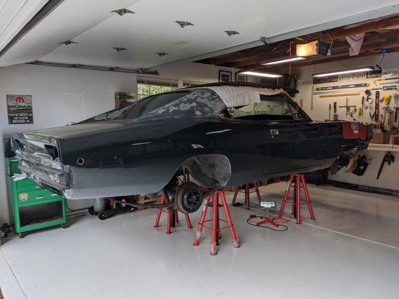

I'm really not certain how necessary it is, but it is always recommended to install the frame connectors and torque boxes with the full weight of the car on its wheels. I always get them tacked in real good like that and then weld them in solid when the car is lifted up on a hoist - similar to how you are setting now. However I have a buddy who has put quite a few in with the cars supported like you are doing, and he doesn't worry about it.
This is solid advice and comports with the directions US Car Tools sent. here is my plan - since I don't have access to a four post lift nor will I be putting wheels back on to put in the connectors, I'm going to jack up the rear diff and the front control arms to replicate the suspension "being under load." It's not ideal but it's the best plan I can think off without towing it somewhere to get this completed (not really an option). Thoughts?
