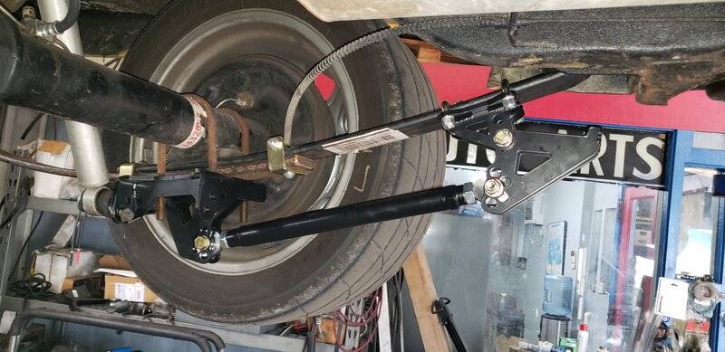

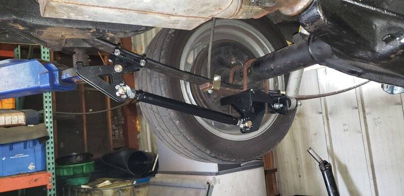

Assassin traction bars and Calvert split mono leaf springs:
I sat in the car so he could measure and mark the sliders to weld them on.
The sliding bolt is going to be close to the middle of the slot when finished.
I really like the Assassins! I see my spring perches are nice and flat too!

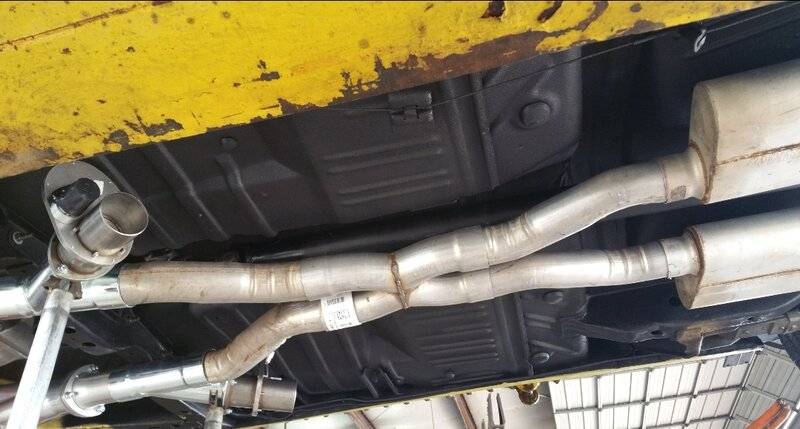

Going through my pictures, this is when I had the Doug's 3" cutouts and X pipe installed. This is before the pipes were completed and hangers mounted and the system snugged up to the body.
The area that is tight is by the X pipe.
