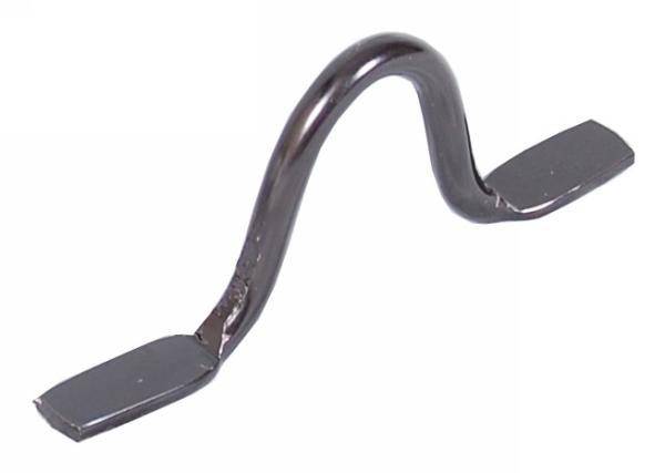

Where exactly does this hook go in trunk area?? This is the hook that the jack spring hooks to. I looked back in my pre trunk pan cut out and don’t see it in original photos.

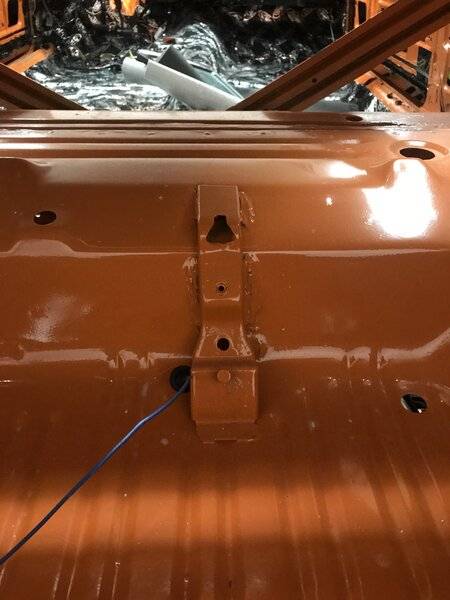

Yes. It came with jack mounting bracket, but I don’t see it even on the internet pics or my pre tear down pics. Says it goes on trunk extension, but my jack mounts under spare and doesn’t get near the extension??
Thanks. I got a whole kit that has wing nut, slotted bracket, spare threaded rod, etc.

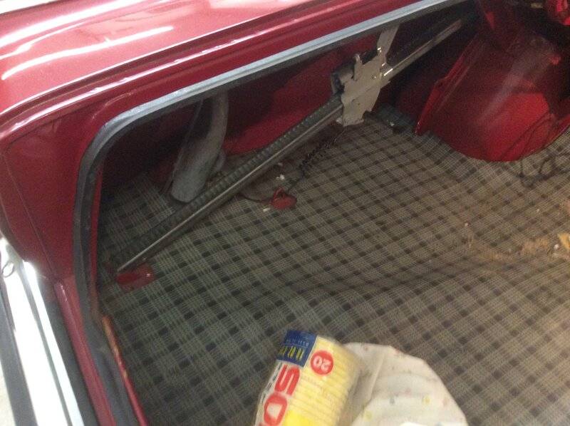

66 Satellite. The red spot to the right of filler neck is piece where spring hooks.
