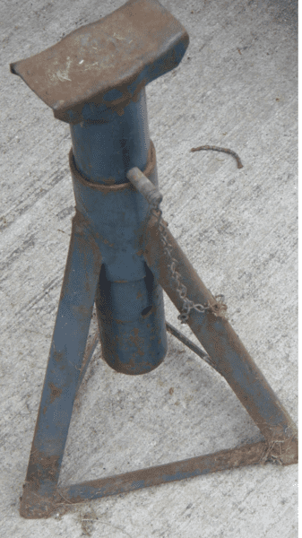

I'm glad you ditched the three leg, I had some (not sure what brand). I read somewhere about an incident where one of those three leggers failed/collapsed. I use some Autozone brand now (blue with pins) which look alright, at least they have four legs.

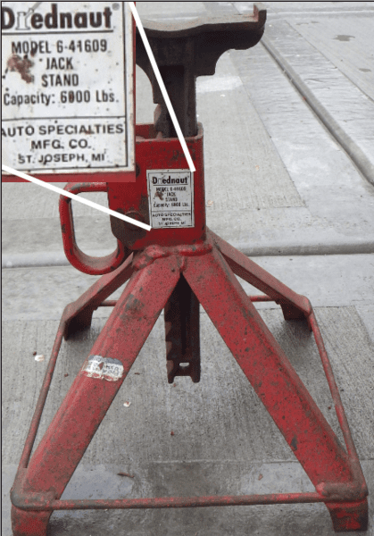

Don't know the history of the US Jack brand. Curiously I have similar stands with the same PN from the mid 80's. Really solid IMO. Never had anywhere near the rated 6K on them.
