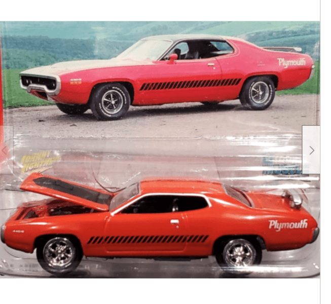

I know I will get a lot of tomatoes thrown at me, but I'm planning on putting the Johnny Lightning's "PLYMOUTH" rear wheel fender decals on my 1971 Roadrunner. In all fairness, I don't know Johnny Lightning other than the fact it's a brand of die cast models from 1969. I'm 42 years old, so I'm slightly wet behind the ears to recall the die cast models.
I saw a picture of the Johnny Roadrunner (pictures provided below) and I really dug the rear decal on the rear wheel fender. Plus, it's only a decal. I figured I'll put a good quality coat of wax and then see how it goes! I have the decals ready... they're about 35" long and 4.5" wide.
I've done my fair share of decals.. but this might be the longest one. I'm open to any tips or advice. Thanks guys... and I know some of you purists will want to hunt me down!! But go easy on me... the girl leaning on my violet Roadrunner likes the idea of the decal... so yeah, you guys know how that goes!! And yes, I'm the guy in the pic! Hahaha
My RR is the violet with the white top and the model I'm using as a guide is the orange red. As you can see the model I have to go off of is a little rough around the edges, so I'm hoping someone out there can provide a good guide to use like the side fender light. Thank you guys!!!
