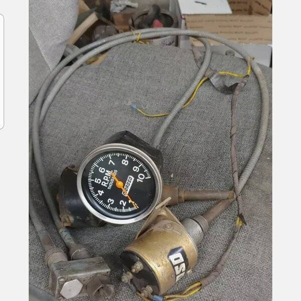

Mine
I had one made by Texas Industrial Electric Co. The guy on the phone knew exactly what I needed. Relatively cheap and quick turnaround. The one they made for me looks like a speedometer cable though, it does not have the metal sheath. Not sure if they offer that type of housing or not. It's much lighter without it though, the metal clad one I have feels like it weighs like 5 lbs and that's for a shorter (4') small block one. A metal-covered BB cable would probably be 10lbs!
You could also give this guy a call and see if has one laying around or knows where to get them.
I might have one shoot me a PM with the actual length you need.

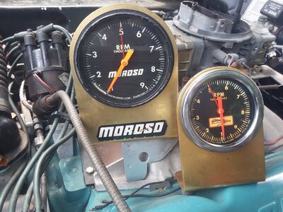

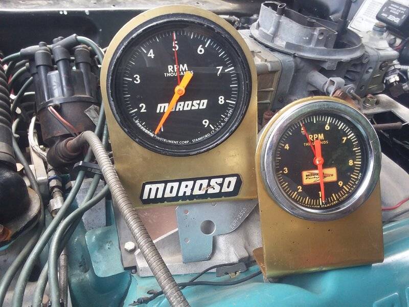

Missed it. I found one in my own stash...ironically. Never knew I had it. I tried to hook it up, but the square, female end that goes into the tach is too large. The one on the ebay ad looks the same. Do they make different size square ends, or is my tach's male, square end worn? When I hook it up to the car, the tach needle vibrates back and forth pretty badly. Tried a second tach, and it did the same thing.
I do believe they bounce, it’s a mechanical connection after all. Should smooth out at higher RPMs? If no then there has to be something that’s not right. Have you tried to lubricate it and see what happens?
Have not lubed it. I can tell that the cable is still solid. If I hold one end, I can't turn the other. It really appears that the male, square end of the tach is spinning inside the female, square end of the cable. I have a Stewart Warner cable in my '64 Fury. It works perfectly and smoothly. I hooked the new Jones Tach up to that distributor to check for accuracy.
Only other thing I can offer is to put the small end in a drill and see if it’ll spin the tach like its supposed to.
