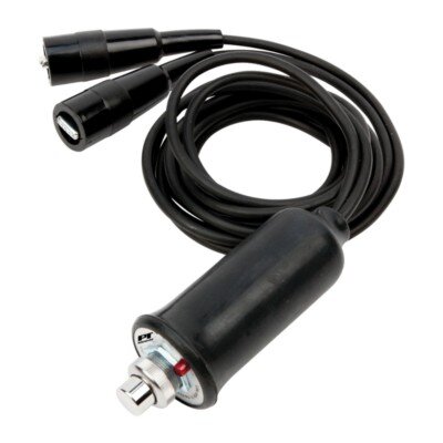

I have and use a clip on push button starter switch that does exactly what a screwdriver does. I use it for many reasons including bumping it over for torque converter bolts.
Like I said, I usually overkill. The quality remote starter switched are 12 gauge.
And adjusting valves.
is funny to see 12 gauge wires but that funky weaky clips to hold "suposselly" the load the 12 gauge would hold LOL.
and still being strong clips, the contact surface is minimal related to what a 12 gauge wire is able to handle
The chart says 41 amps for 12 g. I know the relay doesn't take 41 amps to trigger. Unless there's a short or some other issue. I sold hundreds of 12 g. jumper leads and they would come back to me looking like a toaster ribbon. Oops.
I have one of those for testing under hood. Also comes in handy for adjusting valves like you said. The big wire on the starter direct to the battery is where the load is. Those buttons with 12ga are more than capable with those clips to trigger the solenoid.
