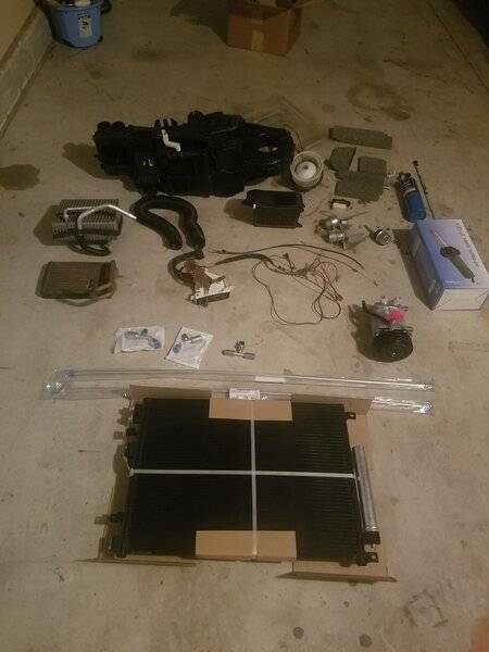

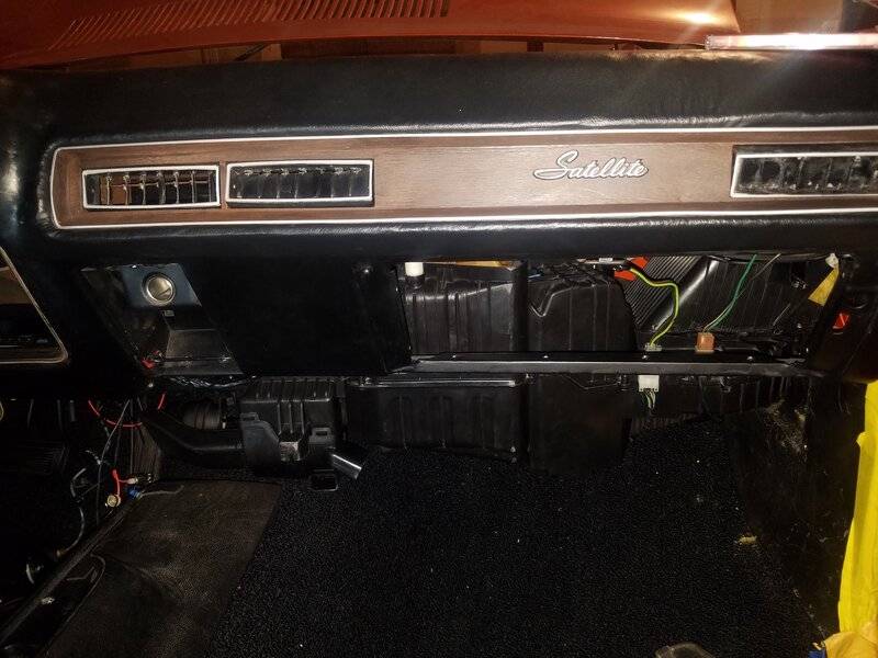

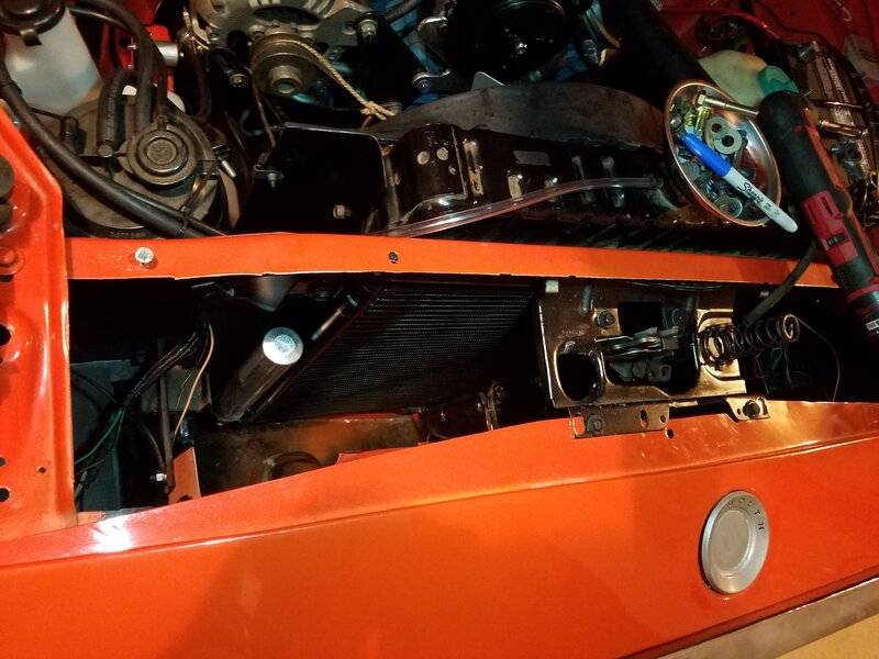

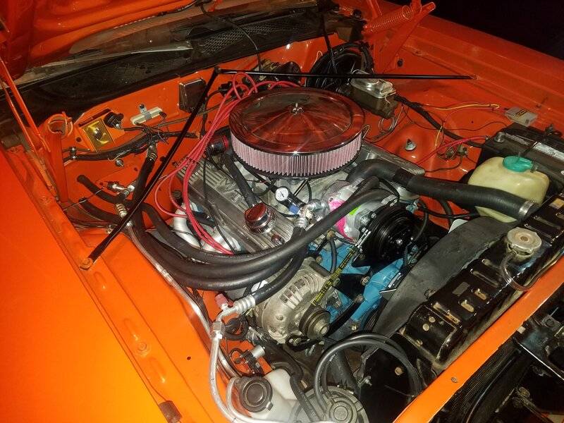

I thought I would follow up on this thread... I did a "junkyard a/c" but not for $500. It was really closer to $1000 but the majority of the parts ended up being new to eliminate the worry of destroying the compressor. If everything was junkyard parts you could cut that down closer to that $500 mark.
Parts:
-The compressor is a Sanden sd7h15 model 4664,
-The condensor/dryer is for a 08 charger (comes with integrated trans cooler)
-HVAC unit is out of o 95 ram with heavy modifications to the case, evaporator and heater core,
-Controls and vacuum resivor are also 95 ram
-Vents are oe 71-74.
-Defroster ducts are vintage air.
-Expansion valve is for a 90 jeep Cherokee with r134a
-Lines are DIY with fittings and hoses from Nostalgic AC Parts
-Lots of fabrication and a textbook on HVAC design involved, but it works how I wanted.
Still need to fine tune the freon capacity and have the control panel 3d printed (pandemic shot that down with the library being closed) but it has been working pretty well for the past year.
