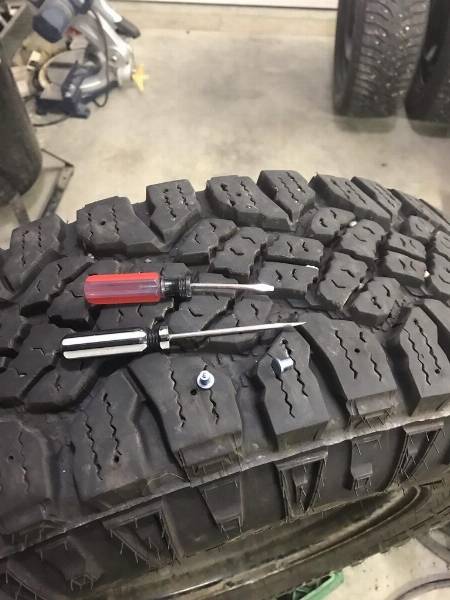

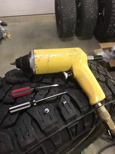

I'm in Northern Canada and I purchased a stud gun a few years ago so I could stud my own tires....wasn't cheap but it's paid for itself many times over. Winter tires are generally cheaper if they are not studded, but usually have the stud holes already in the tire so I buy cases of various size studs and filler er up! Most tires I've done are 14" to 17" and they use about 75-125 studs per tire.
And nice thing about having my own stud gun is I can swap out the studs every couple years as the tires wear and the studs dull. and it's almost like a new set of winter tires.;)
Tires for the wife's car...old worn studs on the right, fresh studs on the left.
I've never heard of restudding a tire.
How long to get them all out of one tire??
To re-stud a tire...probably less than 30 min to pull all the old studs with a couple small screwdrivers, then just measure the tread depth and choose the right wheel stud and install new studs....so maybe 45 min or so do one tire.
I'm sure the tire manufacturers will claim that your can't or shouldn't do it but I've done several sets with no issues at all. I've even studded tires that I've bought used, they had the holes for studs but had been used at least one winter and now the holes were full of small rocks and debris...those take a bit longer because you now have to clean out each stud hole then blow out with compressed air before you can install the new stud.
