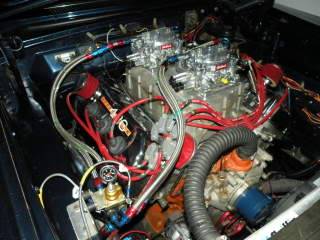

i just switched out my 800 edelbrock afb performer carbs to the thunder series avs edelrock 800's.
they seem to react real nice at idle and response.
going to try them out tomorrow at the track. i went richer on the secondaries for the 1st time. i always went square or a little richer on primaries.
acording to my o2 alert a/f setup, im showing a tad lean lon wot, i think a little richer might get me some more mph, i hope.

heres a few pictures of the new setup.

I have used a few of the OE - AVS carbs. 2-1/2 turns is about where you want to start after you get the jetting right.
well, it didnt work out too good off the hit, secondaries came in way too late, big bog off of hit but still managed a 1.37 60 foot. ran 9.89 @135.45
i pulled them off and went with my old carbs, 60 foots were 1.34-1.35 all day.
i reset the secondaries to open up earlier, going to give them a try next time out.

Actuallllly, not those carb exactly, the OE carbs I have exp. with. With your set up, these carbs are going to need a bit of tuning. There not really intended for what you have.
Ahhhh, the joy of tuning. Try a half turn tighter on the secondaries.
Ah crap, I missed this.
wouldn't tighter make them open up even later. i thought i need these to open up very early because im at WOT off the hit. i need all i can get for a great 60 foot.
Yes, your 110% right, I typed it in reverse. Tighter ='s later opening. Sorry about that blunder. But it's still a half turn I'd suggest.
