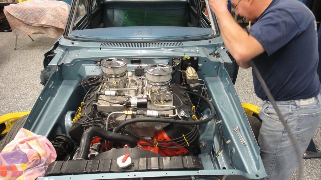

I've got the modified harness on my 65 Belvedere. I ran the module harness through a hole (somewhat inconspicuously) by the master cylinder and mounted it under the dash. I still have the newer style voltage regulator on the firewall, but I don't think it's all that noticeable.

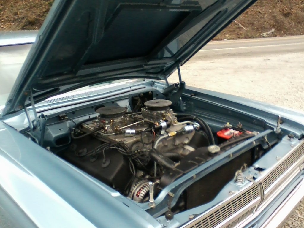

We put the base Petronix Ignitor 1 kit in the stock single point distributor in the 65.Other than 2 wires coming out of the distributor everything else is 1965.the Ignitor 2 or 3 require by pass of ballast. Hits 6 grand shifts no problem.Ran one in a drag car for years.Just a thought..
View attachment 394509 View attachment 394510
dang, that's a tight fit!
Yeah, but it sure was worth it when it was all said and done.(sorry,crappy cell phone pictures)

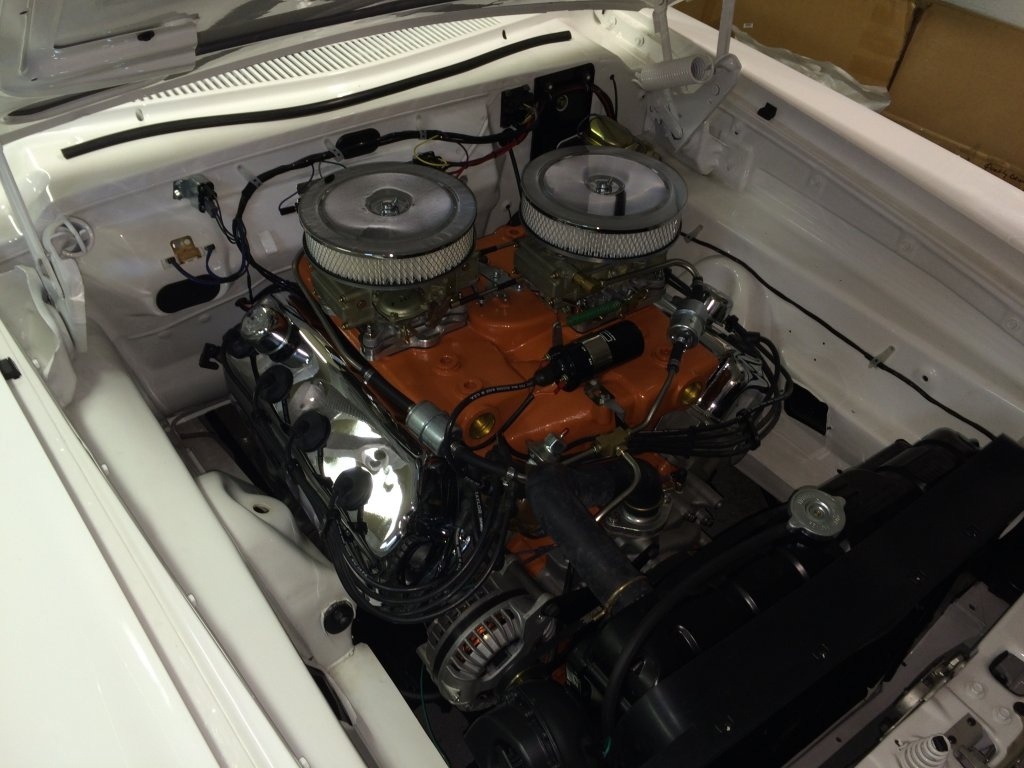

I used a stock standard (not modified for EI) wiring harness and put an MSD box under my dash. I upgraded my VR with an electronic unit. I have the ballast resistor but added a bypass wire on the back.
I also have a tach drive distributor and mechanical tach that will be going in shortly.

that's sooper clean looking install, nice work.
