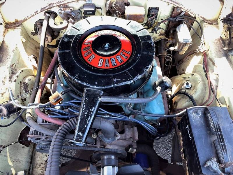

Here's a pic of the carb. It's got a leak and that's probably not helping...
I'm pretty sure it will do better with a stock intake and carburetor as long as the engine is in good shape and everything else is stock.
I'm not really surprised the engine runs like crap with that MacGyver combo.

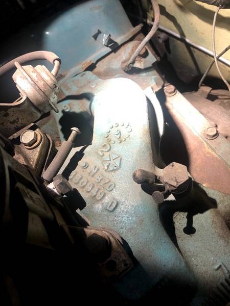

Hmm so it's possible it's not a 383? It doesn't have the engine number on the front left so I'm assuming it's near the distributor, making it a B engine.

I think you should identify the engine first before doing anything else.

What other engines could fit a 440 intake? Where exactly should I look for for a number?

Yes. Looks to be 383 just eyeballing. Newer air cleaner?

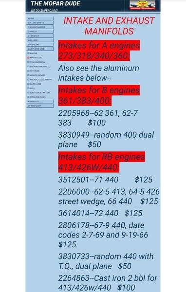

General consensus on Google is that that Thermoquad manifold is 75-76. Get 2 opposing views though, one says 400 and one says 440. Both can't be right as one is low deck and one is raised. Intake won't fit both. But a Thermoquad never came on a 383.
"The Mopar Dude" lists it as a TQ intake for a 400. You need to check the block itself for numbers. But, a 400 intake will fit the 383. But even parts guys make mistakes. Definitely need numbers from the block.

There should be a pad in front on the block that will say 440. Also, if that is a #'s car, the VIN should tell you what kind of engine is in it as well as the fender tag if it has one. I've had fuel leaks and it will make the car run crappy. Where's the leak coming from? You need to fix it because that and that plastic fuel filter are a fire hazard. I'm definitely no expert, but have had similar problems. Vacuum leaks will cause it to run lousy too. Make sure the carb bolts are snug. Original gas tanks can have crud in them that restricts fuel and can really F things up in your carb. Definitely check the plugs.
