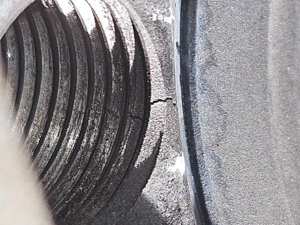

Everything started clicking for me this year. Won some races. Got the car into the 9.30's. Decided I needed a little more power to complete in 9.50 class during summer months. Was going to send the heads and intake out for hand porting.

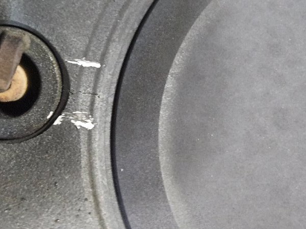

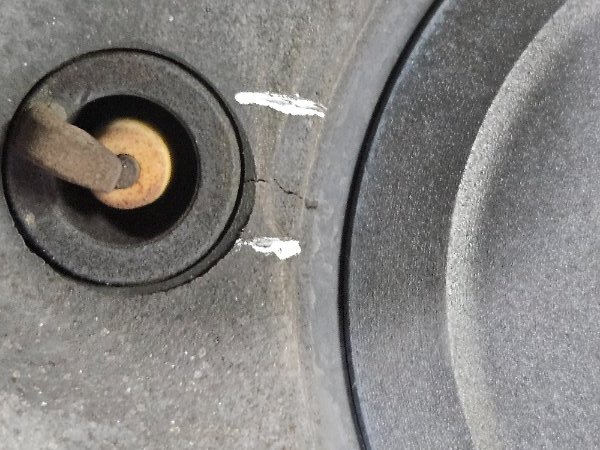

Got the heads off yesterday and found this.
3 different gen 3 hemi experts say they've never seen them crack there...
my luck continues...
Can that be repaired? I assume that the hardened seat is fine.
