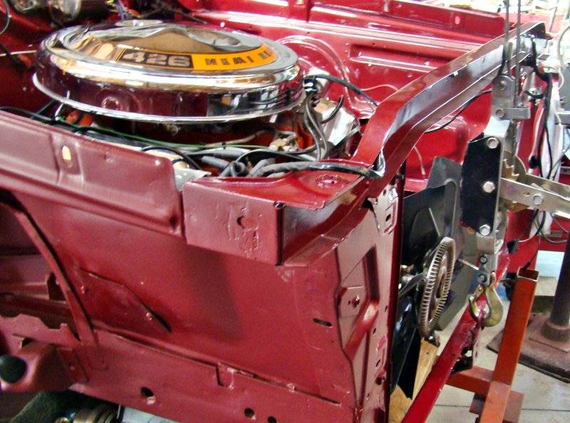

Initial when I purchased the K frame 3 years ago right after I had my motor rebuilt & transmission...... I was told that it was a 66-67 hemi K frame.
when i checked it out myself it did fit my hemi motor so I installed we..... so Great i thought........ so I installed it as you see it now.
This is my first Mopar car..... so I had a "supposedly knowledgeable" B body Member here that I paid (bigbill) to help me install it.. and guess he did not see it either...... i did not see any numbers on the frame.
it did not dawn on me until I started to fit the shroud radiator.... there was no room for it.... panic time!!:BangHead:
it was brought to my attention that the hemi motor is to far forward..........
I have been told by several B body sources it may be a hemi superstock K frame 64-65 with the hemi skid-plate too........... it appears to be that introspect.
The rocker arm clutch shaft fit nearly correctly too...... i have several driveshafts that will button up to the Dana that worked too....... and that may be a issue coming up?

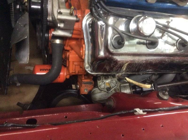

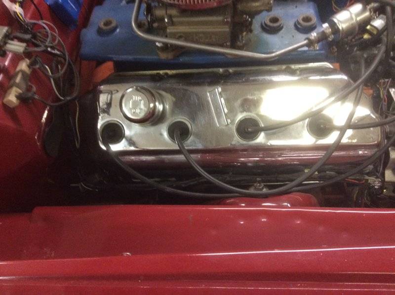

I took patter from a 66 hemi K member made the mounts. Mocked in my 65 Dodge engine with mounts on it. Have 5/8* X-ram clearance to firewall. In hindsight should have moved engine an 1"to 1.5" forward. The Swap meet headers dictated engine placement.

Thanks everyone I am lucky enough to have found a original 67 Hemi K from one of are members here on b bodies....
The swap out is going to be interesting by myself.

I took patter from a 66 hemi K member made the mounts. Mocked in my 65 Dodge engine with mounts on it. Have 5/8* X-ram clearance to firewall. In hindsight should have moved engine an 1"to 1.5" forward. The Swap meet headers dictated engine placement.View attachment 1398436View attachment 1398437

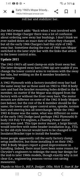

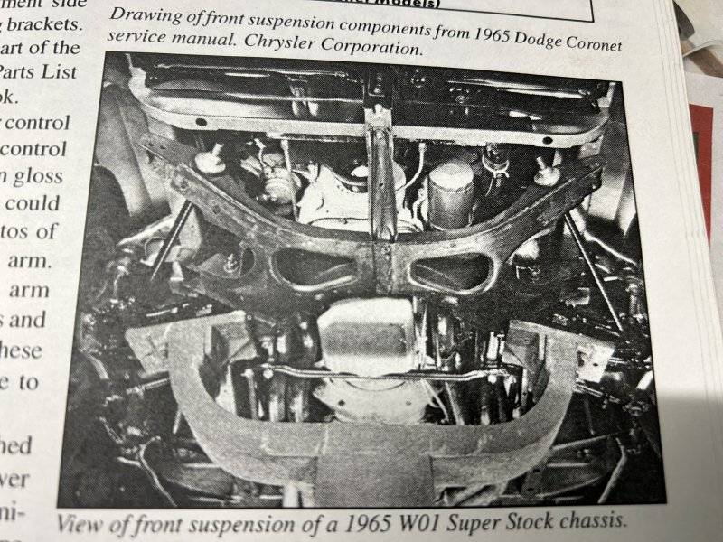

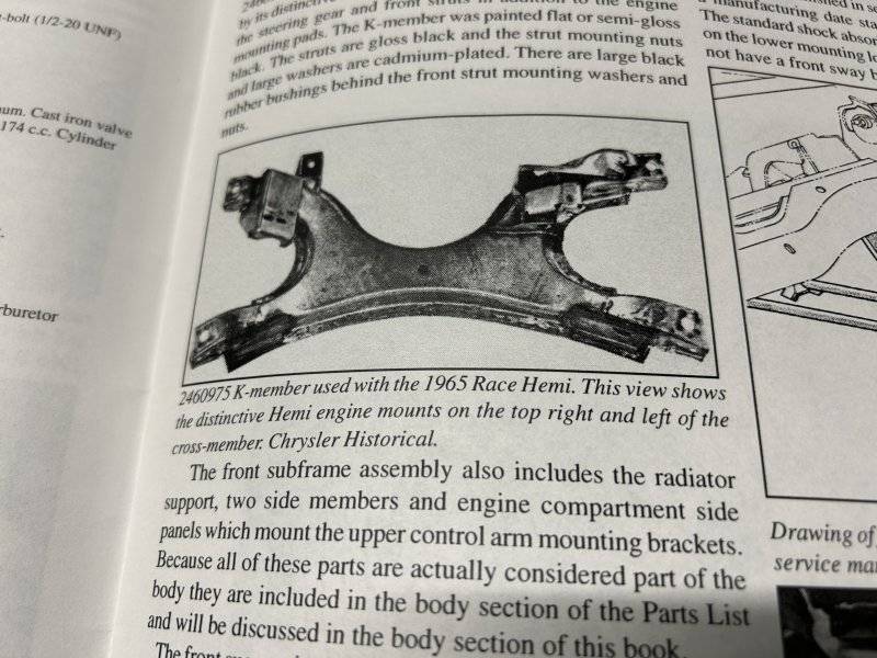

This is the 64/65 Hemi
k frame they did not come with skid plates and in no way did they have sway bar
Speaking of sway bars, I cheated and used an E-body one on my '65.
