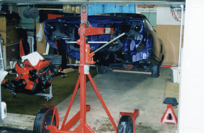

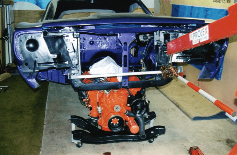

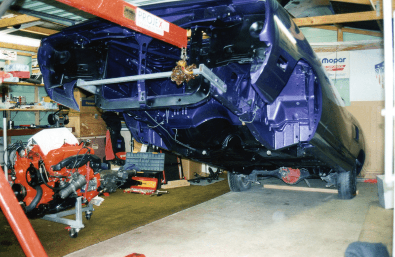

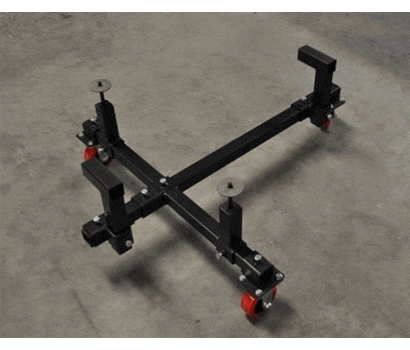

I built this one about 20 years ago....still have it ...similar but different
Used it several times with no issues....I know some here won't like the design, but that doesn't matter, because it works for me. :thumbsup:

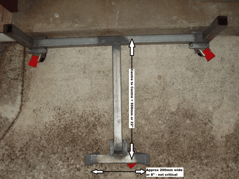

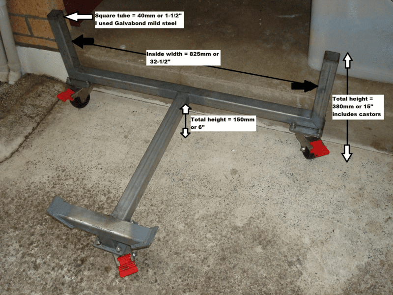

I built the one Cmmopar posted on the thread above and it’s has all the materials and dimensions
