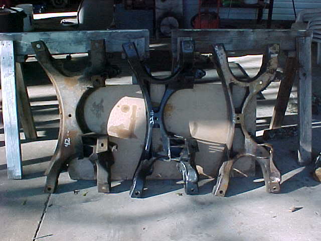

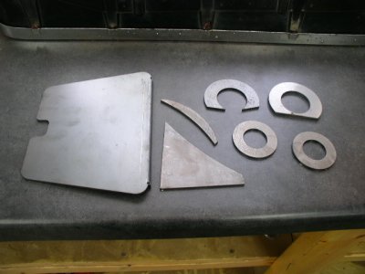

Here's a pic. Notice that the one on the left is 42 lbs and the one on the right is 26 but it still needs a bit of work and some added gussets but I think it'll end up being right at or just under 30 lbs. Lots of work but imo, worth it. It's not too hard to get rid of 10 lbs. It doesn't sound like much but every pound counts when you're trying to put one on a diet. The one in the middle was for a street car.

That's so cool Cranky! You put those things on serious weight watchers diet not to mention the additional ventilation going on there man.
Nice work brother !
Sorry the pics are not better but so far so good on the process.

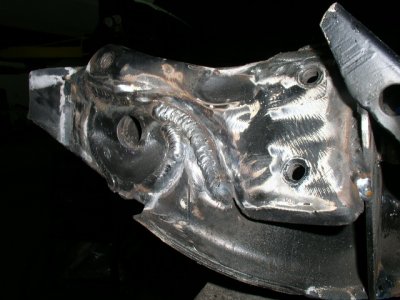

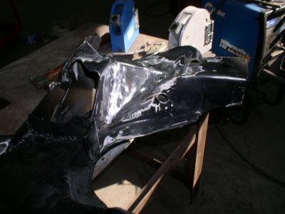

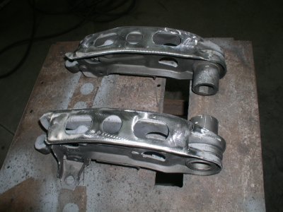

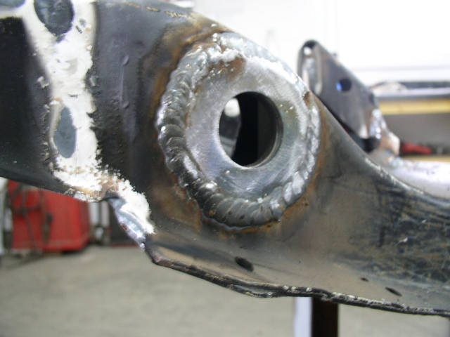

Thanks again brother. Did you happen to take any photo's of yours after it was welded up?

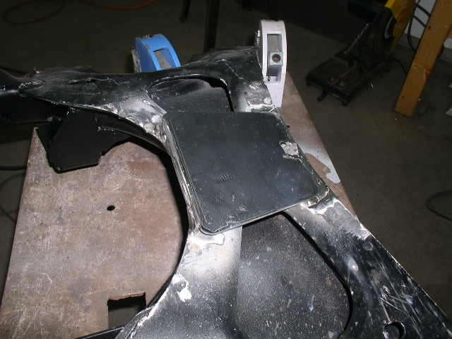

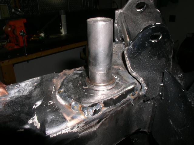

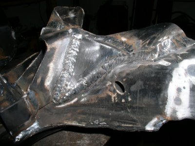

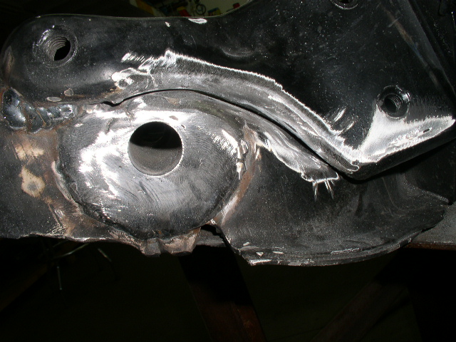

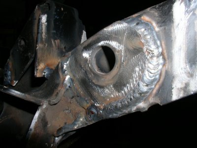

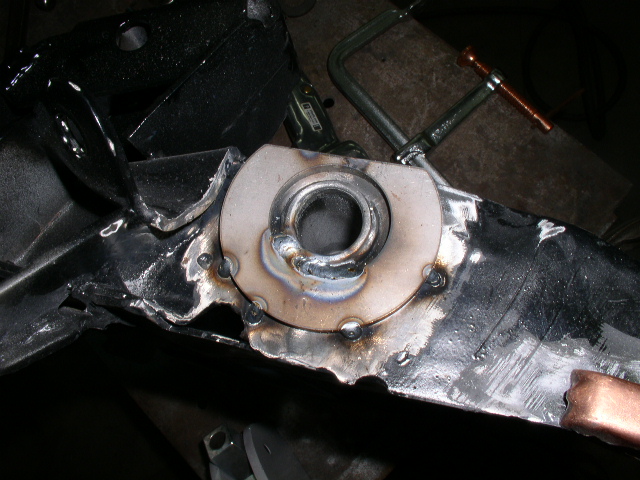

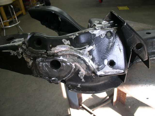

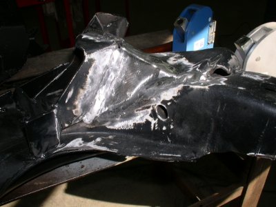

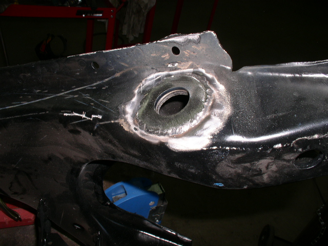

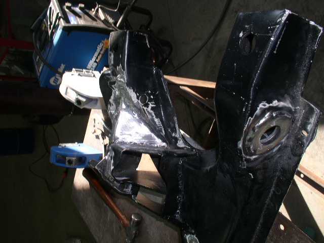

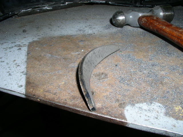

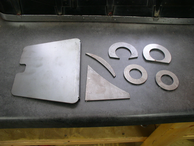

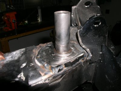

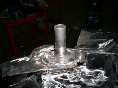

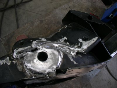

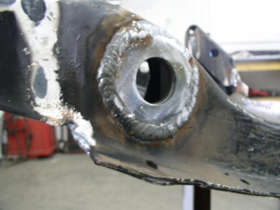

By golly I did. Here is what I could find easily. You will think it is way overpriced when you open up the box, and it probably is. But then I started thinking how much time it would take to make everything without a pattern. I also rewelded every joint on the k-frame- this will take a couple of hours, and it is definitely not lightning it up like Crankys' pics.

That's some serious reinforcing!! I'll be doing a few things that's similar but nothing near to what you've done. Most of my work is geared towards drag racing and not corner burning but if you plan on doing some wheelies, then you should reinforce it like that lol. Great looking work too!
My goal is to get my welds to look like hunt2elk's welds . . . ok, half as nice as hunt2elk's welds would be nice . . . WOW . . .
