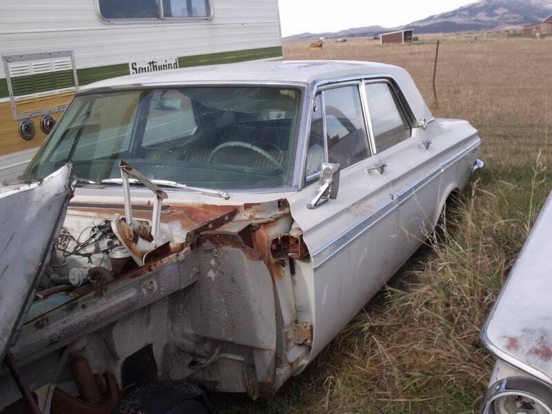

I have a 64 4dr Fury 361 and 727 mostly all there but front clip, would like whole car gone to someone that could use it. cheap. if you can come get it.
