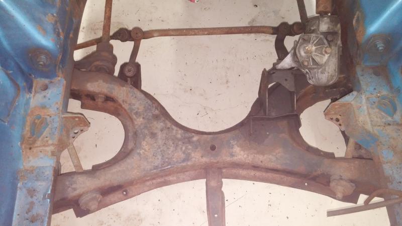

Hope this doesn't sound like a stupid question but I'm relatively new to mopar tech info... I have a 67 coronet that was an old drag car and the old owner ran a motor plate, he cut the mm's off of the k member. I'm wanting to run my bb and was going to to run the plate just to have a cool factor...so I've since changed my mind and don't know which way I should go new motor mounts are try to find a new k member????? I've had 0 luck trying to find a b body k member and the motor mounts I have found I can't tell if they include the lower bracket that actually wells to the k member.... Does anyone have a picture of their mounts or know where to get a set? Thanks for all you're help! FB_IMG_1430761786188.jpg

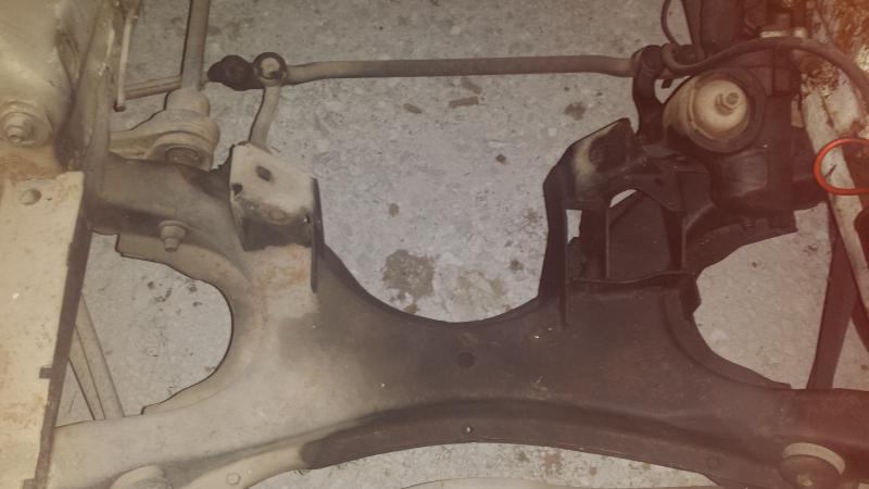

Here a pic of a k frame in a 68 charger to give you an idea what your missing.

I may have a spare K frame. Trying to find what you are looking for is going to be almost impossible unless someone has a bent K and is willing to cut off what I call the receivers that are welded to the K at the factory and then they will probably sit lower than the originals. I'm in Pasadena which isn't that far from you if you want to take a look at what you are up against. Using a plate isn't a bad alternative either though. PM me your phone# and I'll give you a shout if you're interested in dropping by or I can PM you my number. I'm just a few miles from BW-8 south of 225. I usually hit the Hardy toll road from BW-8 whenever I go up that way and it's usually a pretty easy drive....

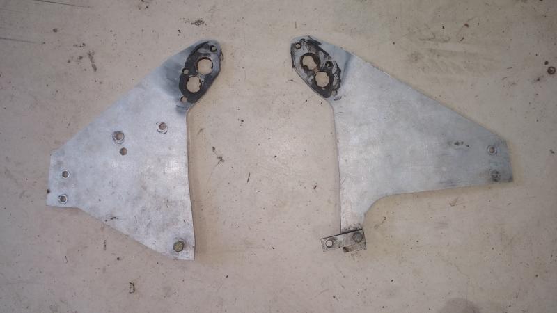

The car is set up for 8.50 class from the inspection stickers I see... All the tabs for the mounts and mid plate are all there. The car came with a 2 pc plate it's not bad looking just needs buffed..... Again I'm not opposed to a plate and actually wanted to run it just for a cockiness factor. My car is a street car but like a lot of people I want it to look and sound the part... I do have as acess to a mill for the water pump but my concern is clearance around the oil filter/ pump.

Since everything is there, I'd rubber insulate the motor plate. You only need the top 2 bolts on each frame-rail. Just put a limiter[ to stop fore and aft movement] from the engine to someplace on the chassis. You can cut the bottom of the ears off.
I have K frame but I am in PA ! I would just motor plate it !!! I ran them for years and am bulding a 69 RR now with one. Very easy to mount an Alt and so on. You can see mine in my Not so stock road runner post. I run a Full plate with a 4 speed and it works very well. Its your call but you already ahead of the game here !!
