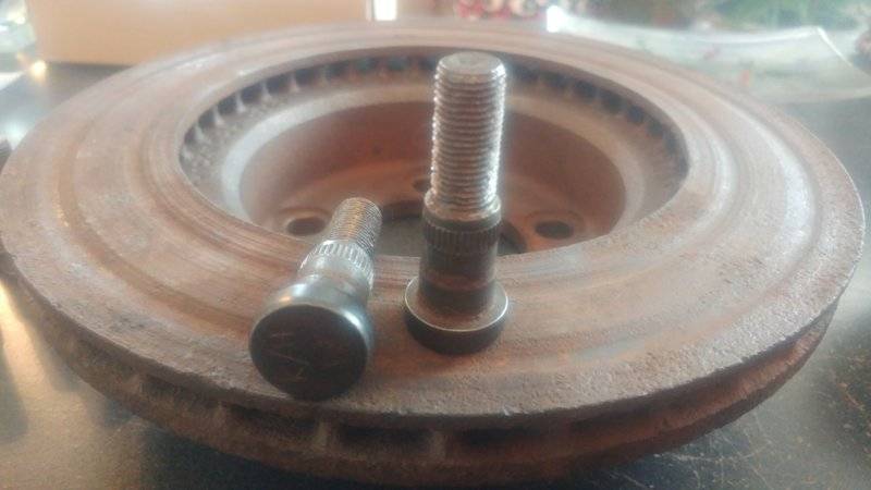

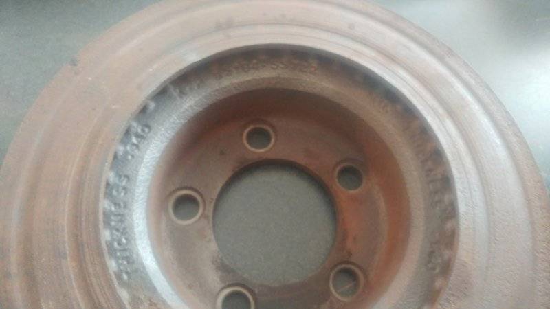

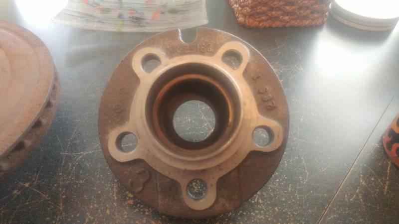

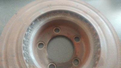

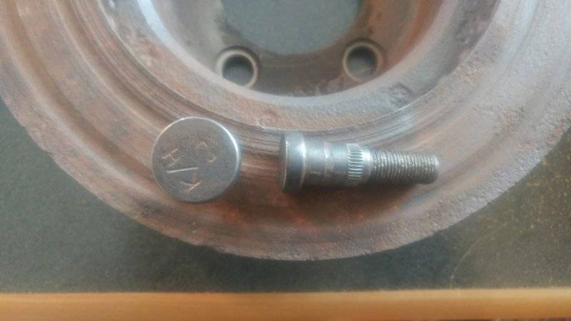

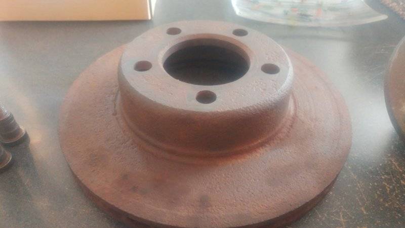

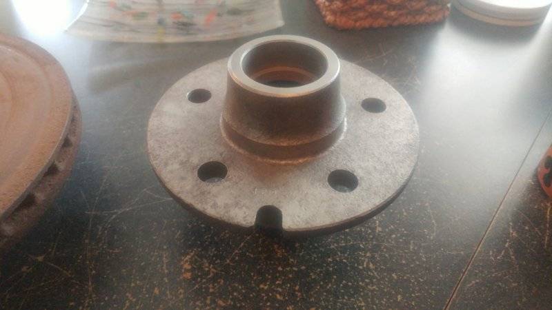

Here are some pictures of an original KH rotor I disassembled. Came apart pretty easy. Studs not swedged like drums.
Hub has Casting KH 85182 with date code 289 1 On front of hub 320 1 which means about a month between casting and assembly into a complete 2 piece unit.
Disc has Casting KH 85184 55722
Studs a KH Stamped, with a smaller length of knurling than the aftermarket one. These where RH.
