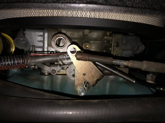

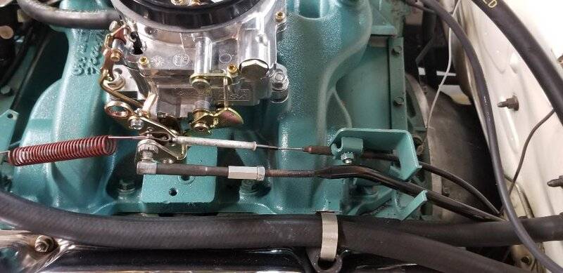

Does anyone know if this fitting is reproduced in a longer version? Changed to an Edelbrock Performer intake & Edelbrock AVS2 changed the total height so I cannot correctly adjust the throttle kick down pressure (need more rear adjustment) shifts into 3rd at 30 mph. I currently have an internal thread barrel nut about 3/4" long in between but it's not long enough. That original factory connector is 1/4 x 24 tpi & 2 5/8" long. Thanks!

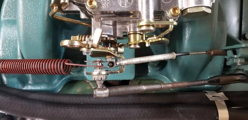

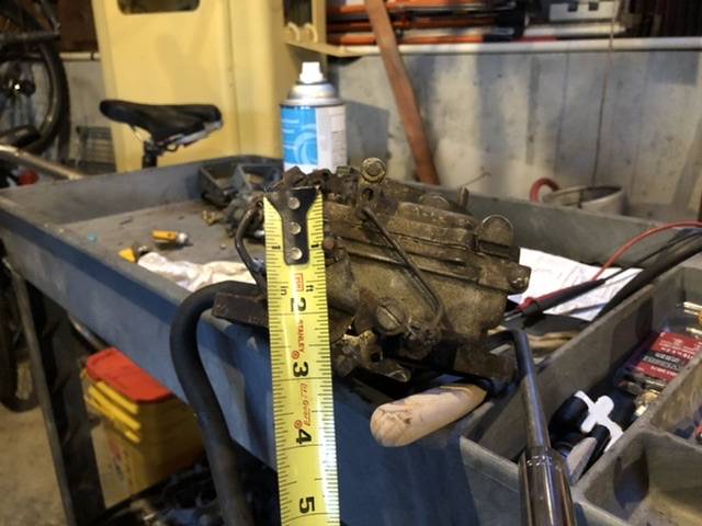

I found that the distance from the throttle shaft center to attachment point (hole) on the factory AFB was 1.12” and on the Holley (with Mopar adapter) was 1.5”. Throttle needed to be halfway down before kickdown was at off idle position. I drilled a new hole at 1.12” and a little bit back from the one provided on the bracket. Works perfectly now.
Oh yeah, with the 1.5” radius the throttle didn’t open all the way either.

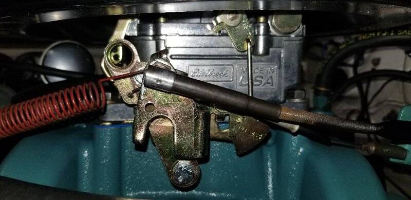

Maybe I need to drop the ball stud down? As you can see the fitting is screwed out almost all the way. The intake/carb really changed the geometry. It's close on the adjustment but not perfect in my opinion. The kick down rod is fully forward and aligned with the ball stud at curb idle. Also your adapter looks diff than mine?

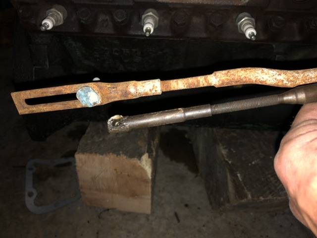

Some more reference...
Here’s a shot of my carb from the side.

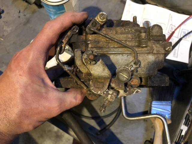

Here’s a shot of the factory AFB. Note distance from shaft to connection point.

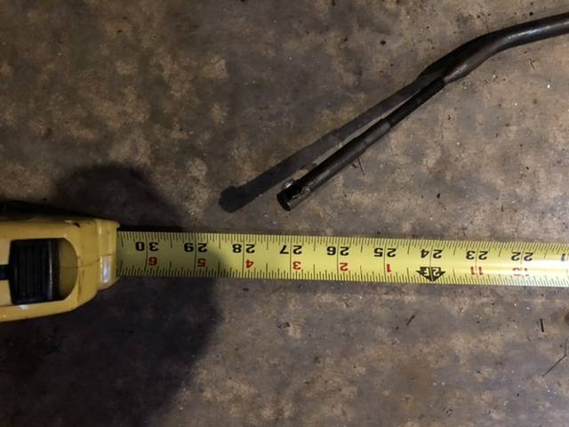

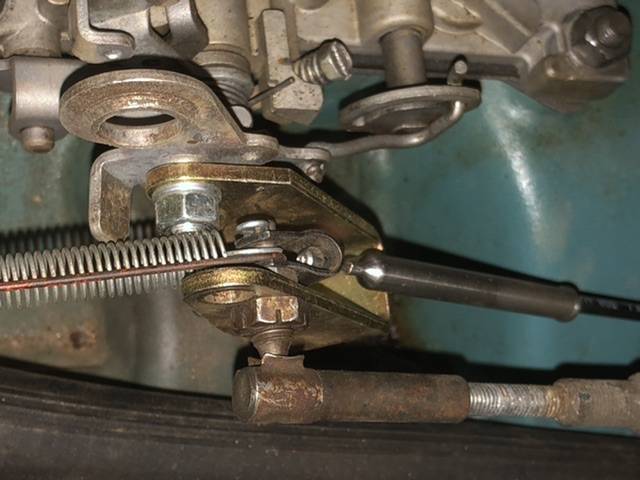

Here’s a 361 kickdown rod (known too short).
Here’s that next to a 440 motor home kickdown with the bottom ends even.
Note that the 361 version is unwound about as far as it goes. Also note that the rod in my car is from an Imperial. Same engine, intake, carb and tranny but different part number rod?

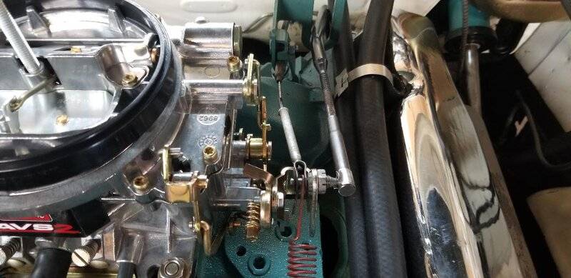

Thanks for the photo's Nate.....Yeah the Holley adapter is def different than mine. And I can't relocate it further down because I will lose "throw" has to be at the top where it is now. Maybe someone with my exact setup will chime in on the subject. Posting up a diff angle of what I currently have....

If you mark the downshift rod where it goes through the bracket at idle and WOT, what's the difference in travel?
View attachment 964214 View attachment 964215

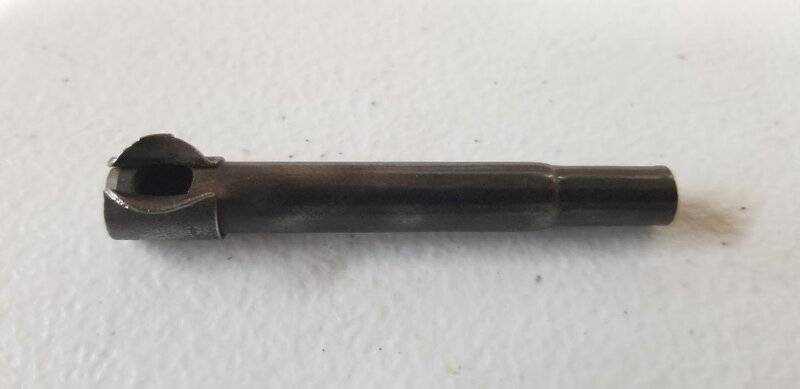

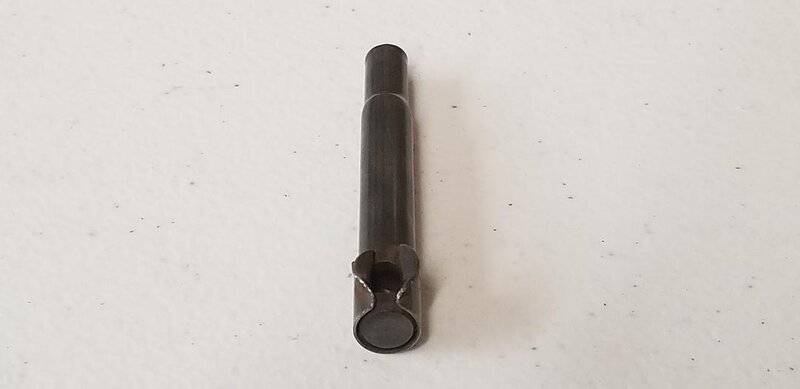

I don't know if you're handy making simple parts but I'd be inclined to cut the rod and tap both new faces. I'd then make a plug that's 1" long with the same thread tapped hole through it. With a couple set screws you could put the new plug into the middle of the rod and extend it. If you ever go back to the 2206000 intake and 3611-S AFB just take the plug out and screw the original halves together.
Ok, So here is what I did using Geff's suggestion. I will try it out next day or so...raining like a bitch here now!
