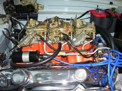

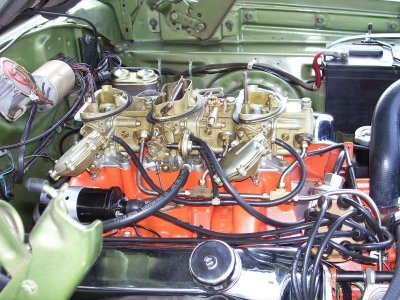

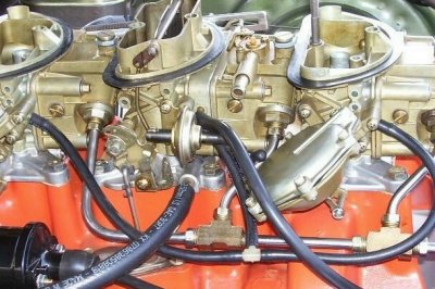

It might be a dumb question, but what is the vacuum source orifice like? Is that oversized, giving you too much signal? Just a thought.
this might help
maybe better pic
Everything is hooked up correctly, just like in the pictures. I called Phil Fish and got some good info from him. He said there were different bleed sizes depending on carb and the check balls should not be there. After discussing it with him he believes there may have been other modifications done. Rather than chasing my tail not knowing what has been done to these carbs, (and because it's cold), I'm just going to send them to him to take a look at. I enjoy working on this kind of stuff, but in this case I don't know what I don't know. And sometimes saving money is expensive. Thank for all the input, I'll let you know what he finds and how things turn out.

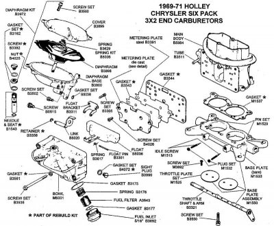

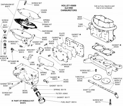

Ron,here is the breakdown on a 3659 Chevrolet 427 Tri Power end carbs and the Chrysler.The original pictures are direct from Holley but the part numbers are different because of a different parts vendor.The Mopar carbs are the same other than the base,the Chevrolet doesn't use mixture screws in the base on the end carbs because of the configuration of the main body.Picture 199.jpg

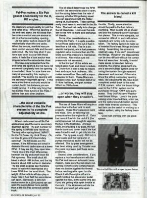

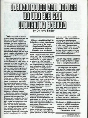

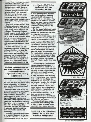

Check this article out, some good info.
Thanks for the in fo guys. Thats a nice 6pk article but they dont mention a check ball. All the Holley vac carbs have the kill bleed as the vac 4 barells have always used that setup even with the check ball as once the throttle blade opens on the vac side the kill blleds then helps hold it open as it gives it more venturi vacum once it opens. Holley says on the 4 barells the check ball is needed so it lifts off its seat and releases the vacum in the diaphram so the secondary does not hang open to long as they say if they dont make the feed hole larger (by the check ball lifting) it takes to long to beeld the vacum out and the secondaries dont close fast enough. They still dont say in here why they dont use the check ball setup since all the vacum carbs have the kill bleeds in them. Anyway thats for the great info guys. Ron
