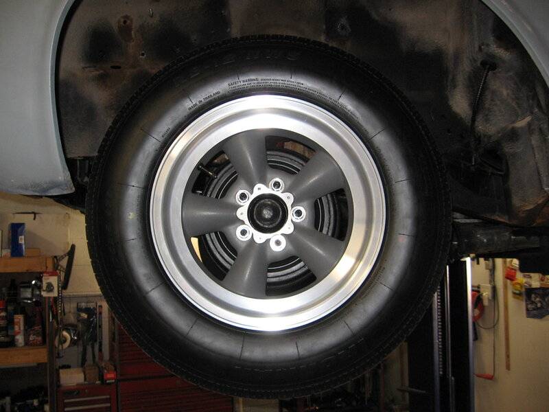

I may be wrong but I believe the rear axle stud knurl is a different size. I installed aftermarket axles on the rear so I can't help you on those.Sorry for the crappy photo of the front wheel.
Another photo of the Torque Thrusts.You can cut the studs to length to use closed end nuts. I run open end.
