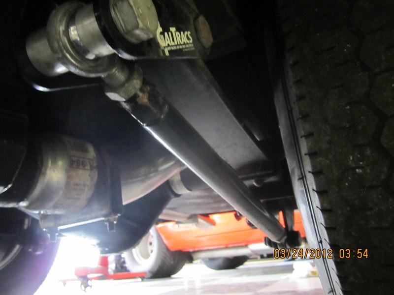

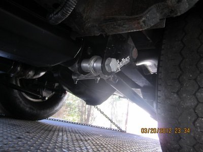

If you street drive alot like I do,ladder bars get stress cracks in time.I made this very choice so long ago,the shocks that came with my cal-trac's are only 5 way adjustable:tongue5:The cal bars can rattle a little,I have zip ties on both sides od the heim joint and that keeps 'em quiet for the most part.Also still use the spool that came with the car over 25 years ago:icon_eyes:
Car weighs 3650lbs,ain't no light weight:icon_compress:
Goes 9.9's with 4 lbs of boost on pump gas.
