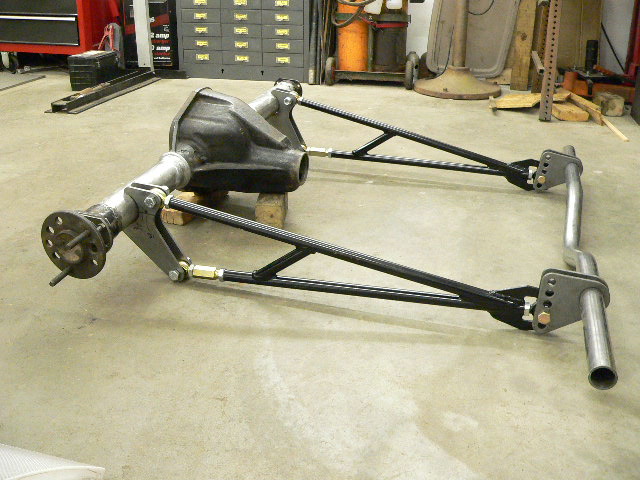

I'm not sure you've over powered the leaf springs. But I'll bet you have over powered your current shocks. I run ladder bars cause they're lighter than leafs, cheaper than Cal Tracks. No issues running 9.20@147 on 10.5wx31 M/Ts
Doug

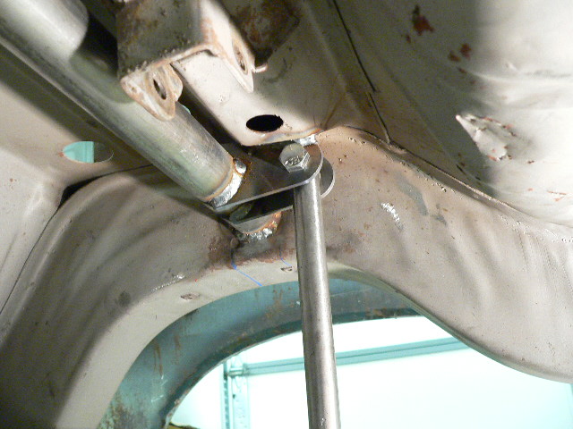

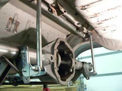

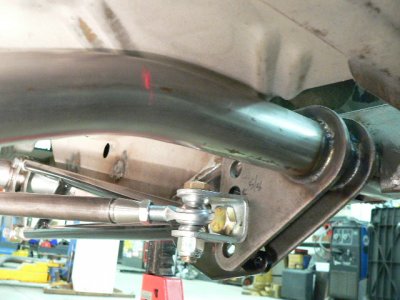

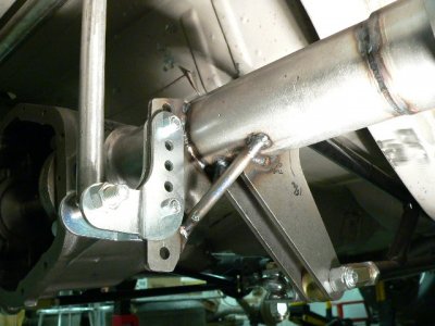

You could do it yourself in a weekend if you can weld. We're only talking about 2 cross members, housing brackets, and spring mounts.
Doug
