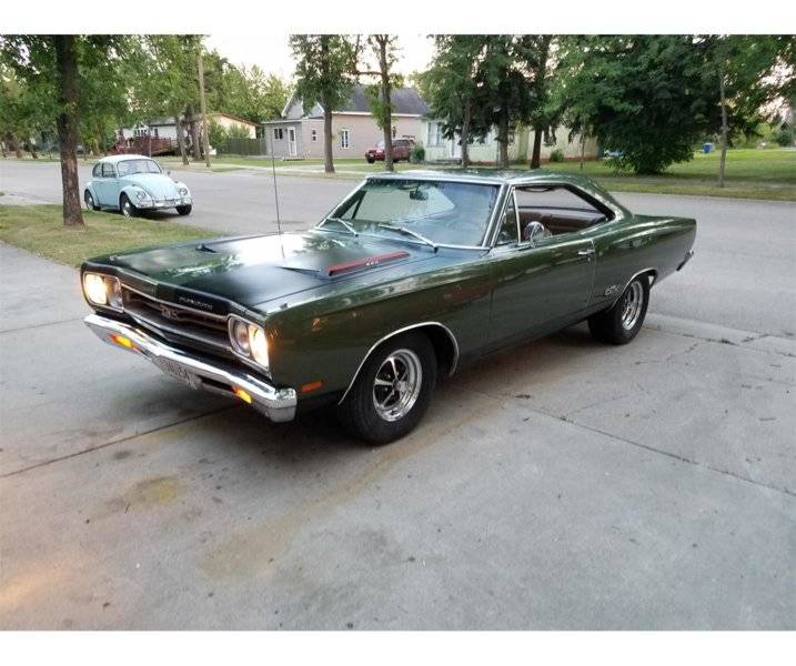

I tried to see how my drag race Duster's 30"x10.5" (actual dimensions 29.5"x10.4") with Weld 15" rim's would line up in my '69 Street GTX? And as predicted. Close. But would need some wheelwell mods to get them to fit. So for late model B-body? I can tell you what doesn't fit. 29.5"x10.4" At least with a stock Dana rear and drum brakes.
8 3/4 rear with discs? Maybe?
