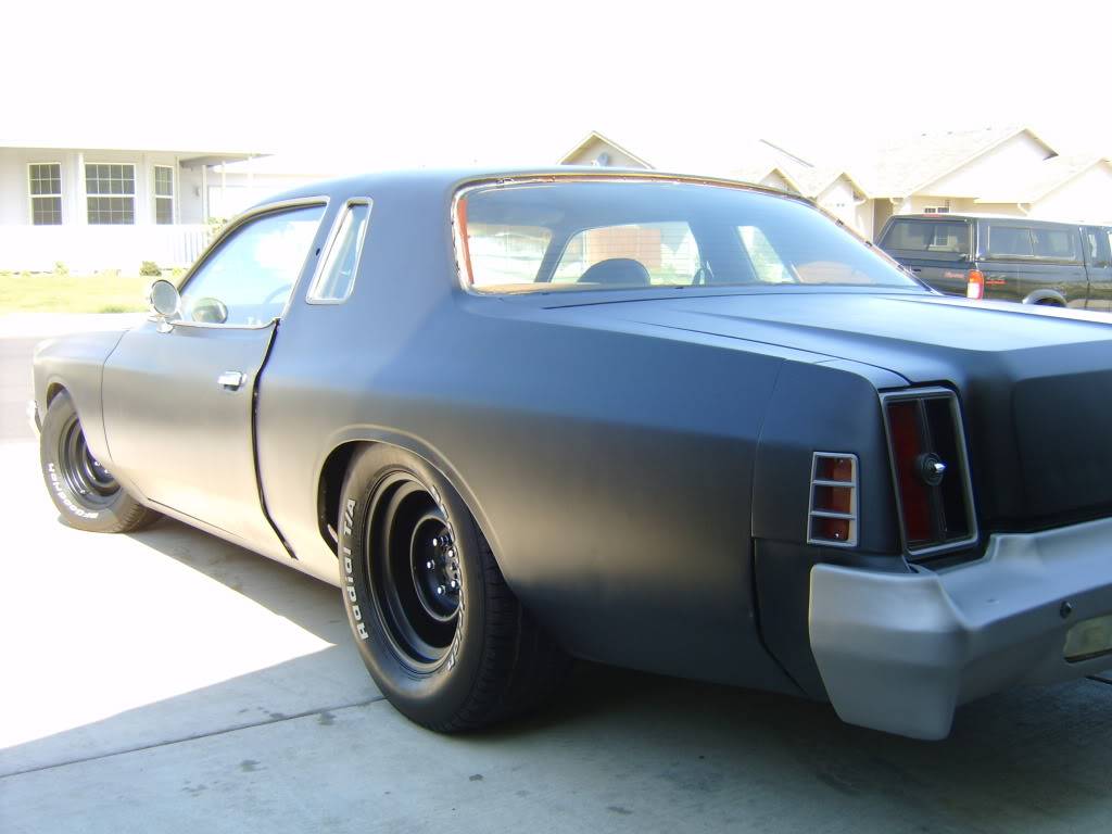

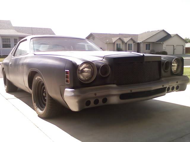

This is an easy one: I've had 15x8's, I beleive the backspacing is 4.5 but don't remember for sure, with BFG 275's on the rear of my Cordoba for almost 5 years. The only problem I had was because the springs had sagged (they have since been rebuilt) and the tires rubbed slightly.
I've got 225's on 15x7's on the front.

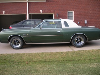

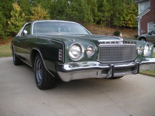

Shouldnt be any problem for a 275 mm tire. I know you said nothing larger that 15", but here's what I've got.....
Those are 265/60 16s on 16x8 rims with 4" of BS. Heres the other side (I guess I COULD have closed the door)...
There's plenty of room inboard which leads me to believe that a 15x8 with 4.5" of BS should fit with 0 problems.
Those are 245/60 15s up front, but 255s on 15x8s whould have fit, and I think looked better....
I've got the 255/60R15 on the back and 225's on the front. Back end also has air shocks to give a little extra lift so I have plenty of clearance. I'm sure I could get 275's on my rear.

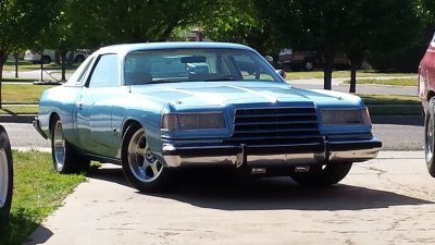

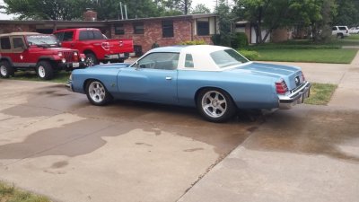

New Wheels!
Ok, well I decided to take the plunge! After tons of research I decided to go with the following:
15x8 Magnum 500's all around, 4.5 inch backspace
255/60R15's on the front
275/60R15's on the back.
The pictures below show the results. My car is all stock...no suspension mods or fender lip rolling. I can't tell you how long it too for me to determine the largest available wheel combo that would fit....almost every shop in town told me that these tires would be too big...especially the 275's...and they fit nicely with plenty of clearance. :headbang:
Nice! Congratulations on your new wheels and tires, they look great. Put up some more pics from different angles.
I usually buy my rolling stock from different vendors and then take everything to get mounted because the tire shop geniuses ALWAYS say it won't fit. I spend a month rolling around on the garage floor with a tape measure and they think they know better than me what will fit...NOT.
Anyway, nice choice on the magnum 500s. Very unique, I don't see many Cordobas with those. I like.

Those look great, nice lookin Cordoba.
