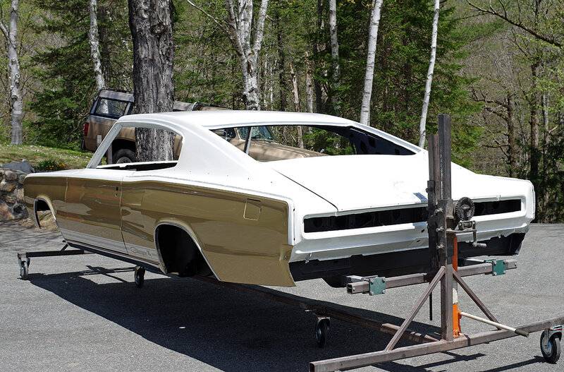

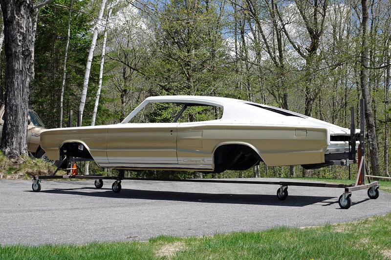

The old 4" wheels on my rotisserie were getting unreliable, so I cut them off and welded a new set of 8" wheels on it, making it much easier to move around. Then I put the chassis back on it and wheeled it outside for the first time this year. Now it's time to put the car back together!

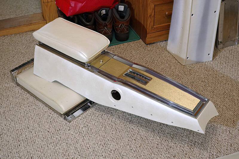

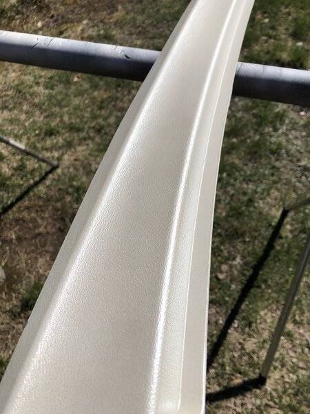

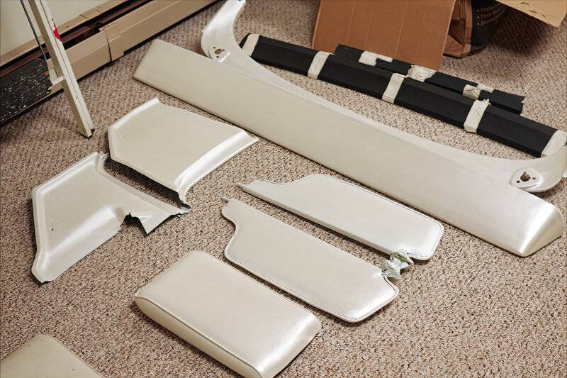

I have also been changing the color of the interior components in preparation for the reassembly. The interior of the car used to be all Black, back when it was a Red Charger. The new look of the exterior has changed all that however. For reasons that are to lengthy and boring to cover here, I decided to go with a Pearl White interior.
I have also given the console pieces a new look to match. First off, I'm using a full length 66 console for my 67's restoration. They were built from sturdier materials, but more importantly, I just like the look better. I got this particular console set from Bobby C. (ODZking) a while back. It used to be Red. I have used my 67 top plate and arm rest etc. Obviously, I have changed the look of these pieces as well, to compliment the new interior design.
Nice work. I agree on the interior color choice.
Doug
Red is attractive and keeping original colors has value.
But I think objectively speaking pearl white has some advantages.
Good choice.
Looks like it has the holes for vinyl top trim. What kind of top are you putting on?
Good choice.

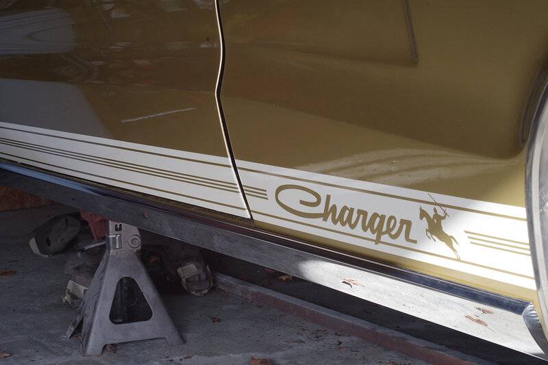

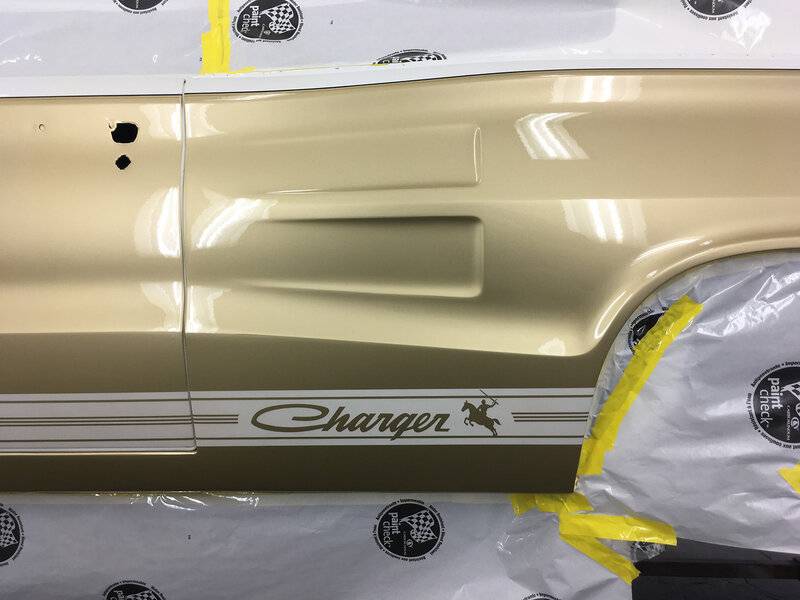

That Charger is also a Birthday Charger, so I designed my own personal Birthday Stripe to run along the top of the rockers. Complete with a Knight riding his Charger, the namesake of the vehicle. That was actually the hardest part; I haven't had to physically draw anything in well over 40 years.
The Birthday Stripe, as well as all of the Hand Painted Pin Striping was painted on the already painted & cleared chassis, then buried in Clear again.
Thank You Brother!

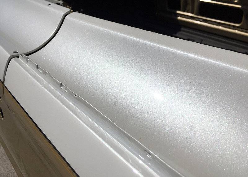

The White looks fairly opaque in the pic's above, but in reality it really shines, especially in the light.
I love it, what products are you using to re dye the interior pieces?
Very, very, nice.
I also put a 66 console I my white hat special, love it.
Mine has the pearl white top. It looks awesome. But it is very, pearly, I guess you'd say. You may want to see if you can get a sample to put next to your white paint, (tri stage?). I have a bright Lexus pearl on my other car, hard to say what that combo would look like.

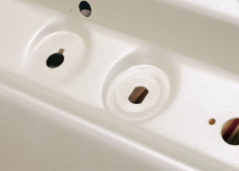

SEM Products... Soaps & Preps, followed by SEM Mystic White for a base to cover the black. Then SEM Ranger White for the final Off White tone needed. I am recovering the original black interior door panels with an Off White vinyl, so I needed to match the color of that vinyl as close as possible. After that everything gets dusted with Pearl from Herbs, which is the same as OER.
I personally like the Pearl from Yearone the best, but they couldn't supply me with the quantity I needed at the time.

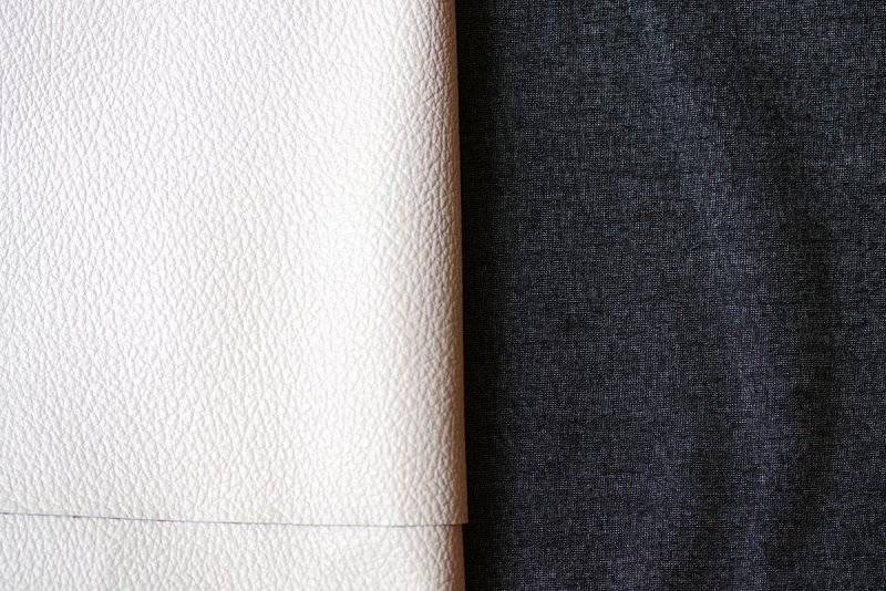

This is a shot of the Off White vinyl held against one of the painted plastic interior pieces. They were each dusted with pearl for an even comparison.
The silvery white seen in the background on this test panel is the Mystic White base color.

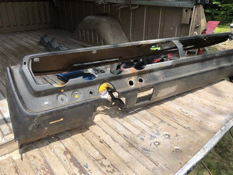

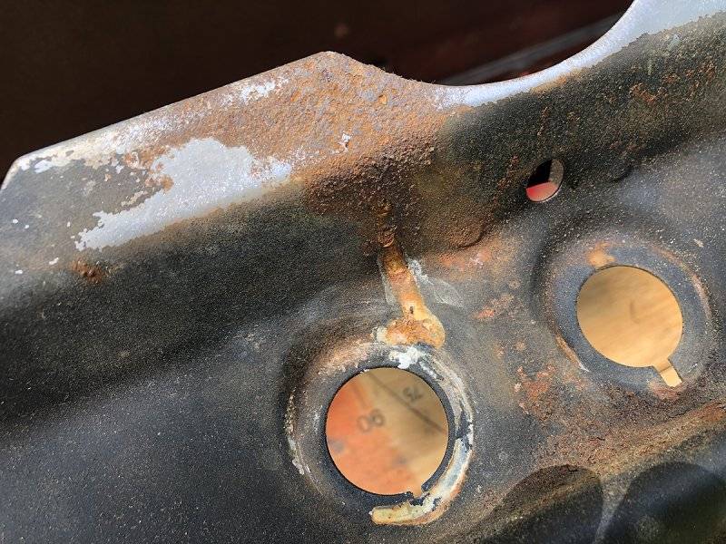

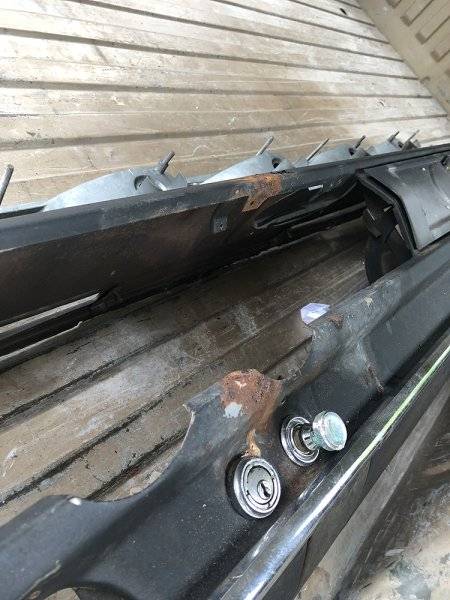

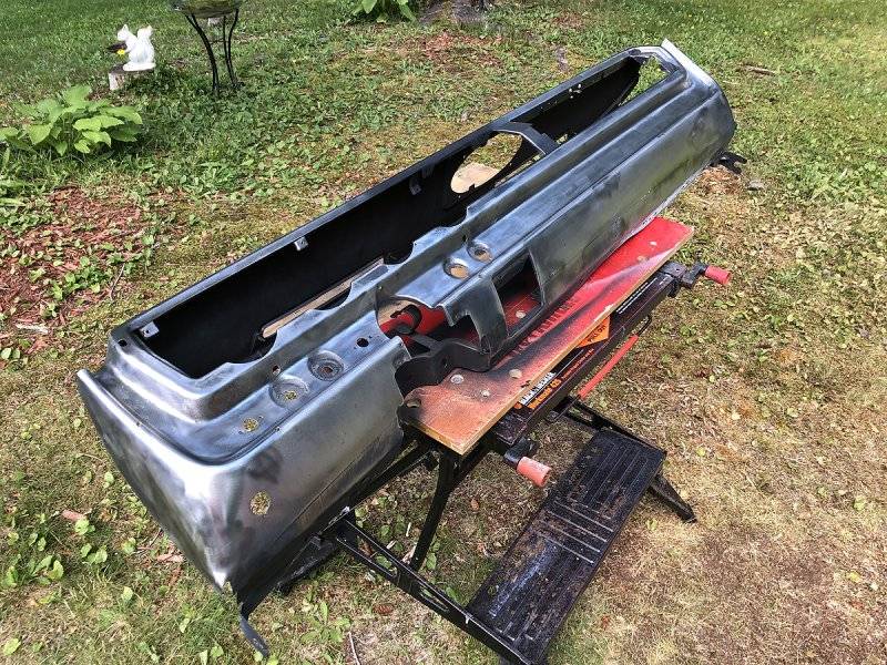

Started work restoring my dash today. It had quite a bit of rust on it, so I stripped it down, then ground & polished as much of the rust off as I could without physically grinding through to the other side.
:lol:

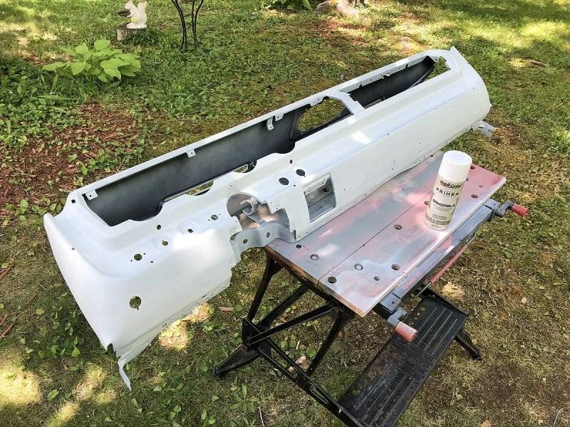

Then I threw some white primer on it. I'll let that dry for a bit before moving forward.

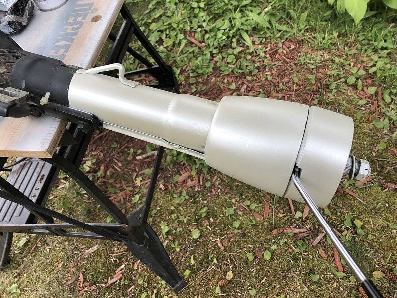

Finished the work on the dash and got it painted up this morning. After that I cleaned and repainted the steering column.

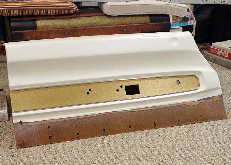

Started working on recovering the old black interior panels to match the new interior. I've only started the one at the moment.
Never done this before, so I'm being cautious, taking my time, so as not to screw it up to bad. :lol:
