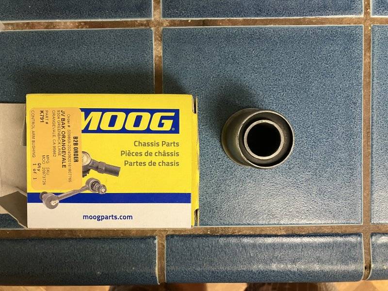

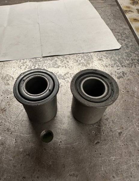

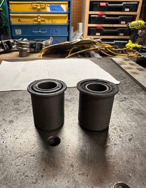

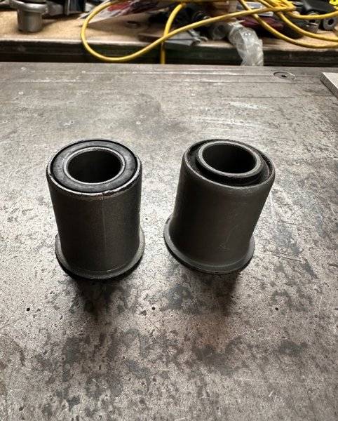

Going through replacing the LCA bushing on my super bee and bought both Moog (K791 $10.21) and Proforged (115-10015 $14.44) Open to any positive or negative experience with either, however it's probably splitting hairs and either one would work fine.
Proforged is made is Taiwan, Moog is made in India. I think I am going to go with the Proforged but just wanted to post some comparison photos if anyone cares.
OD measures pretty much the same on both at ~1.473", the Proforged has a .802" ID vs the Moog at .807" but I'm sure that varies.
Proforged is on the left, Moog is on the right.
if the moogs are a press fit on the pin I would be surprised. I would recommend the proforge

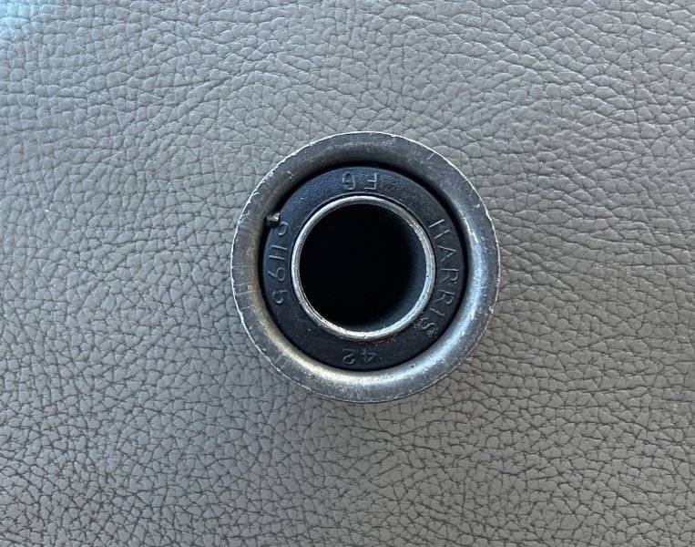

Personally, i have been using Proforged bushings in all the lower control arms that i have rebuilt, then sold, on the A, B, E, bodies web sites, for years, when i found the quality of Moog bushings went downhill.
Haven't had any complaints at all, from the customers that have purchased from me.

Im gonna put this out there just as my personal experience. I purchased Moog lower bushings and they fell right on the pin no press needed. So tried another set
in a AC delco box exact same bushing same manufacturer number and font in the rubber and fit exactly the same just fell on the pin.
The proforge bushings were different manufacturer number in the rubber and fit the pin as intended with a press fit.
If you can’t get the inner sleeve diameter correct what else is subpar?
The proforged actually holds the pin in place the inside diameter on the Moog is just a little bit too big.
Learning opportunity for me, when you say it should be a press fit, are we talking tight tap it on with a mallet, or tight break out a press or large vice to get that puppy on?

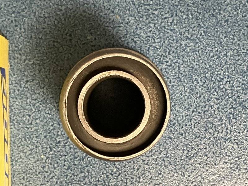

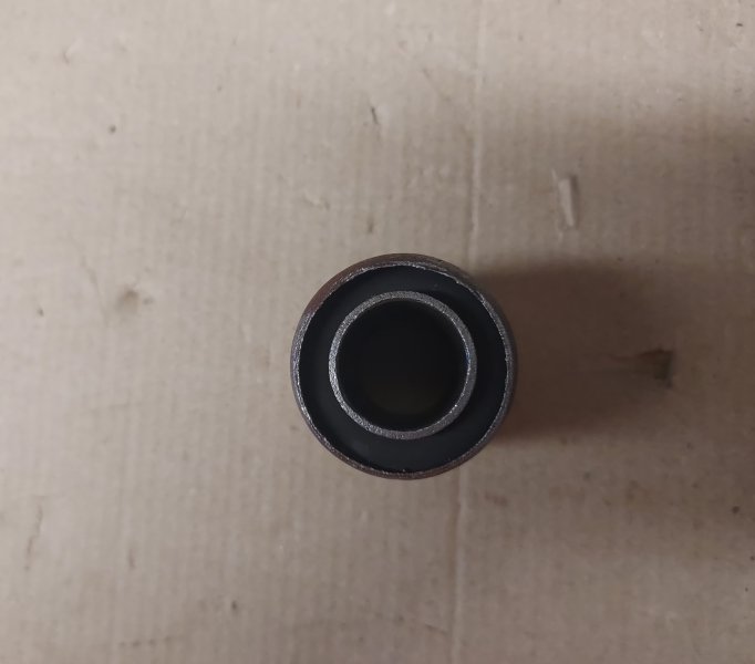

Here is an example of MOOG quality I experienced a few months back:
Offset LOWER control arm bushings? What the heck??
It should be tight enough that you can't hammer them in...
The Moog pictured above is a newer one that's gonna be a slip fit on the pin... The older ones are visually different where the the rubber is visible on the flanged end.....
Craig at Mobile Parts sells old stock, he doesn't source current offshore sourced parts... In my experience his stuff is top notch...
Of the two LCA bushings the O/P has there's no question, I'd use the Proforged
Uhh, no. It was molded off center due to shitty production methods. It was not intentional.
The one I got was definitely off center. It could have made a degree or more of camber difference.

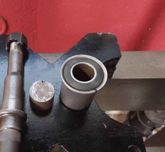

Moog:
Some other brand:
