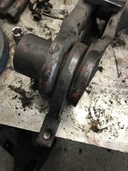

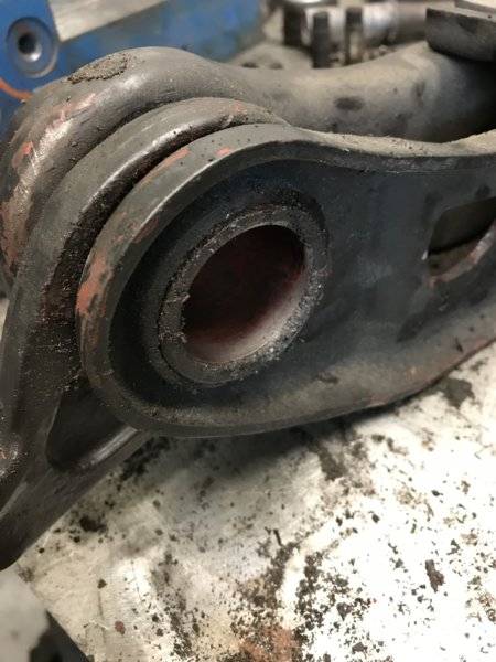

Sorry if my explanation was unclear. I’m afraid the play I tried to describe is not going away by change the bushings. In the pics you can see the part I describe as ”sleeve” for the pivot shaft. This part is not tight in the control arm...

And it won't necessarily be tight until tension is applied to the torsion bar. Some will be tighter than others, but that has to be able to move freely. If it doesn't you are subject to front end squeaks.

My LCA arms had the same radial play, all of them will have it.
As far as i could see there is not precise machining done on both parts.
The 2 plates that make the arm are stamped, hole punched so there would have never been a nice "tight" radial clearance.
As the guys mentioned, when welding the reinforcement plate on clamp the end in a vice to remove some of the axial play.
I only clamped it slightly and left most of the axial play as i did not want to distort the arm too much.

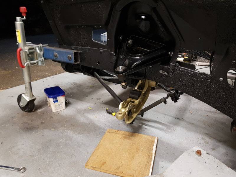

Don't worry, you made a good choice. I went with the PST deluxe polygraphite and the car rides great with no squeaking. I think the higher sidewall with small diameter wheels on these old cars gives a lot of cushioning. My Plymouth rides way better than my modern car. I was also worried about the play in the LCA's but the clamping/welding removed some, and once it's all in place with the torsion bar it isn't a problem. Call it 1960's production tolerances...

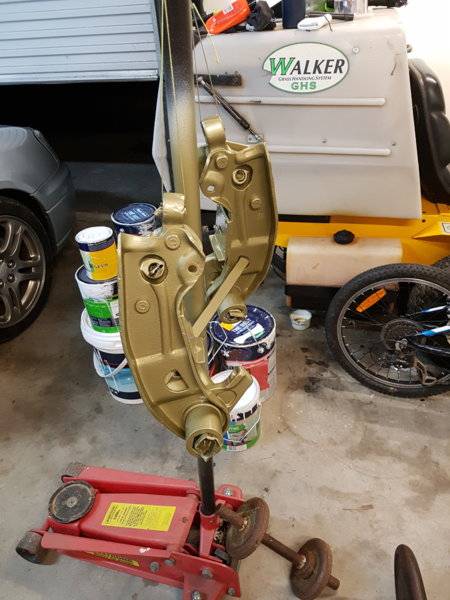

What did you use to get the cosmoline look? Paint?
It's Dulux Metalshield, Hammered Finish, in Bronze. I bought a tin and sprayed it through my spray gun, but it comes in a spraycan as well. It wouldn't satisfy a concours judge I'm sure, but it looks pretty good to my eyes.
