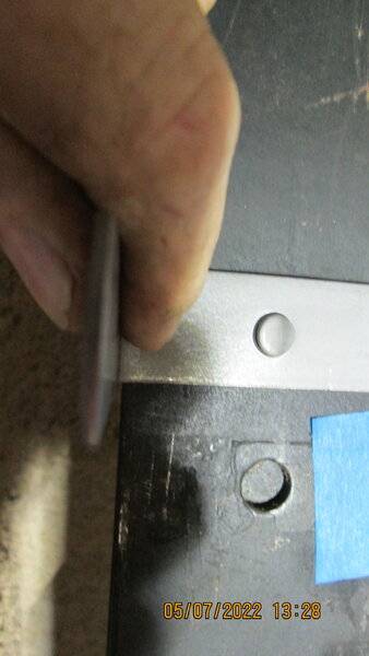

Now the question is what was there stock for that spring? You can tell by looking at the bottom of the spring for markings where the clamp was, also for the clamp locator holes are. Mine are a older set of SS springs ordered for a different car long ago. Took time to find pictures where they went and when it was time to start found out that the spring clamps had a nub, that fits in the hole on the spring. Also was where I had found to locate them. Pictures will help, blue tape next to the spring hole.
