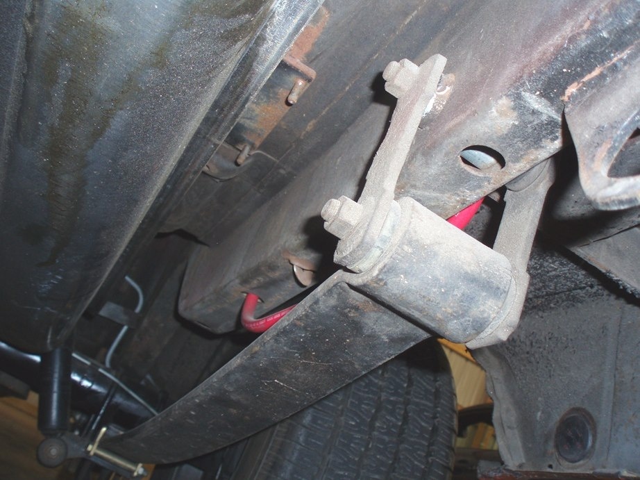

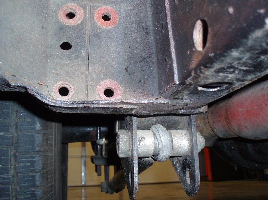

Here are a few photos of the rt rear spring mounting. This work was done in the 1960s. The car has since been updated to CalTrak rear suspension with mono-leaf split springs. The stock multi leaf super stock or stock springs will still fit. It does lift the rear height of the car slightly. Comes out of the hole really well.

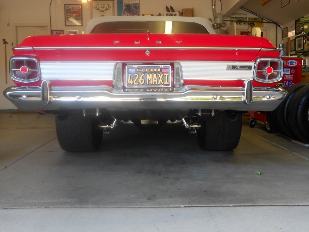

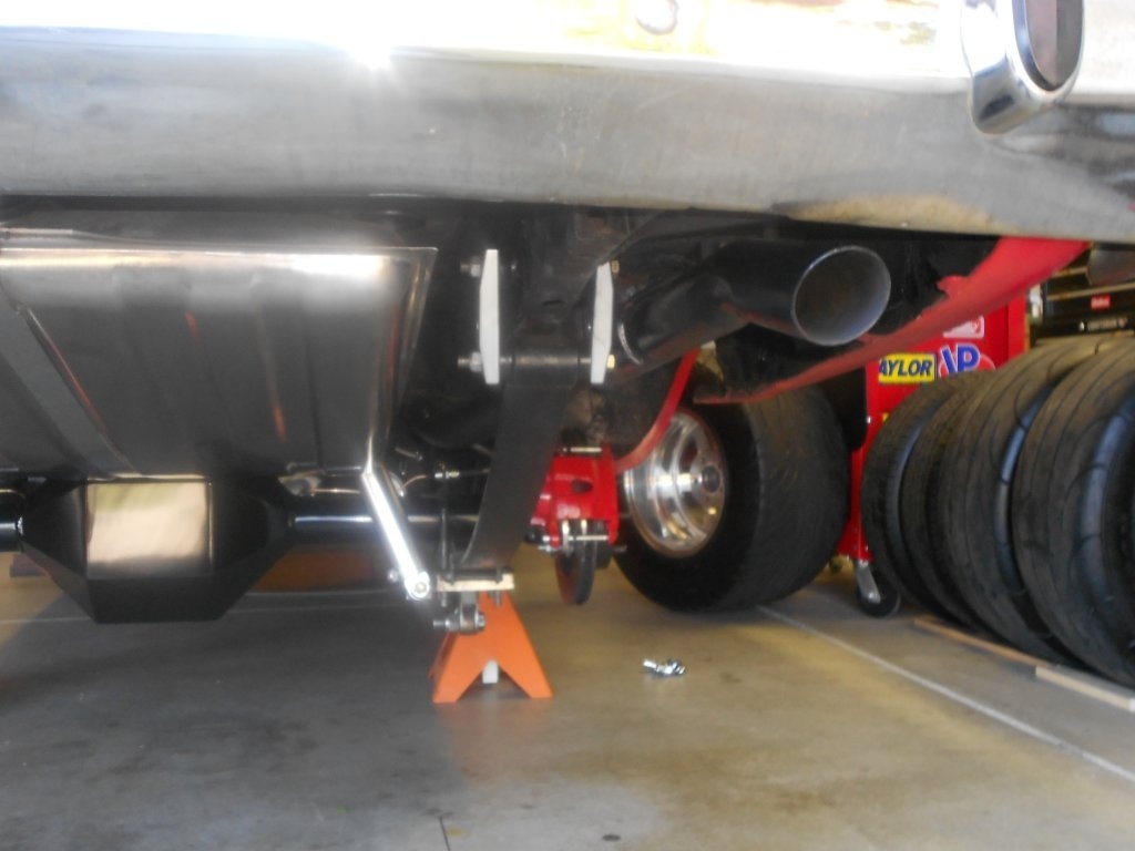

My solution to the tailpipe problem: Moved them above mono-leaf and outboard: Don't even notice the difference in location.
