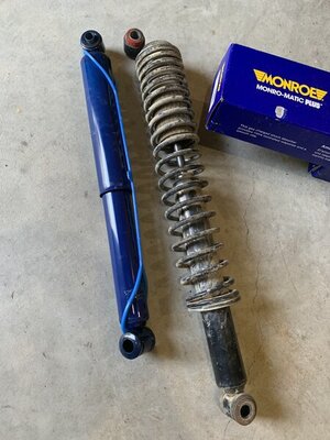

I’ll tack on to this thread as it’s related:
I broke a shock the other day towards the end of a family cruise in my 69 Charger. My exhaust rattles a bit against the gas tank a bit sometimes but this sounded really shitty. Had a peak underneath a beheld a broken shock absorber. Anywho, ordered a set of plain Jane Munroes to replace the coil over ones and found the top eyelet is smaller than the bottom one. The hardware I already have and the mount holes under the car are 5/8” inside diameter and the top eyelet of these Munroe shocks are slightly smaller. They are supposed to fit big block mopars, so what gives? Has my car been modified? Were the bushings changed? Should I just order a set of the coily doily ones that were already on it?
Thanks!
