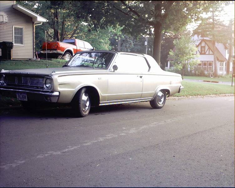

I put a set of Espo's on 10 years ago. They settled a little bit but may be a 1/2". They were even 5 leaf and not 6 leaf like came on the car. (15" tires do help the look. but the middle photo was 14's.)

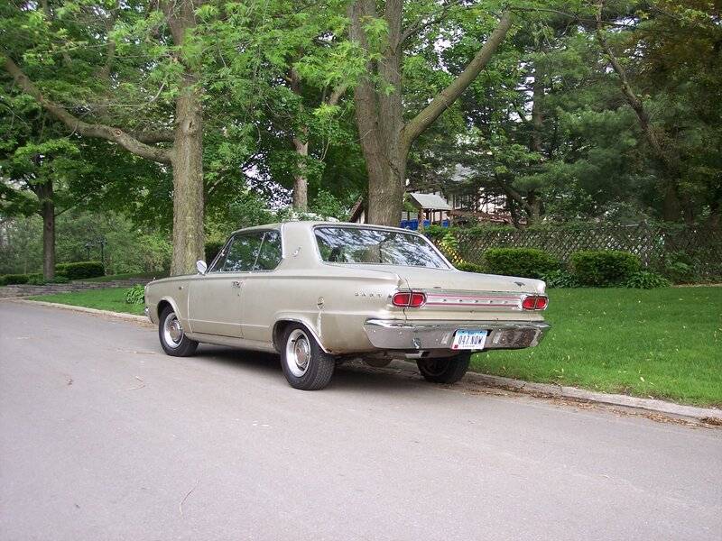

Eaton springs on my 63 2'' drop and 100 lbs increase.
The 100 lbs increase make the ride height look factory. Trunk was empty.
Thanks for the pictures....both cars look great.. The plan is to go with the ESPO's.. 6 full leaves +1" on ride height. The front already has the larger .88" torsion bars so hopefully we will be good to go...
