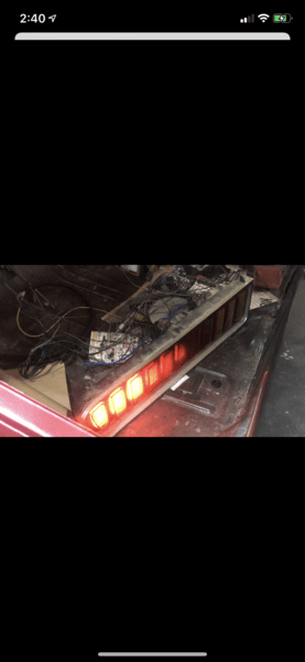

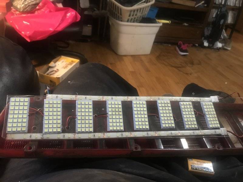

My led tail lights I made they flash light mustang tail lights
