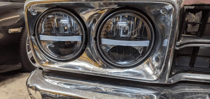

Just wanted to share how happy I've been with these drop-in replacement headlights:
https://smile.amazon.com/gp/product/B08CDDHHWK/ - not an affiliate link, I make nothing if you buy. Pick a charity! Shout out to Doctors Without Borders.
Here's a vid of them installed. Hard to tell from video but nice spread without blinding oncoming drivers and look really sharp.
https://photos.google.com/photo/AF1QipOvKu7OLZTkn_X45RsNMY5xiKSsp8c8th8fWUnP

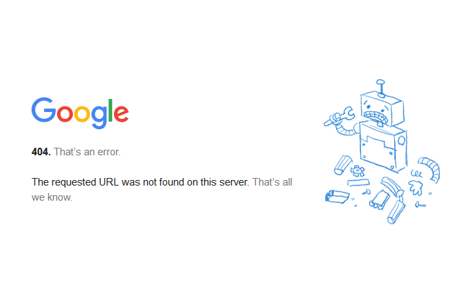

Your google photos give me this :(

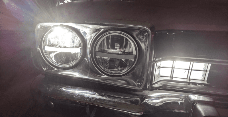

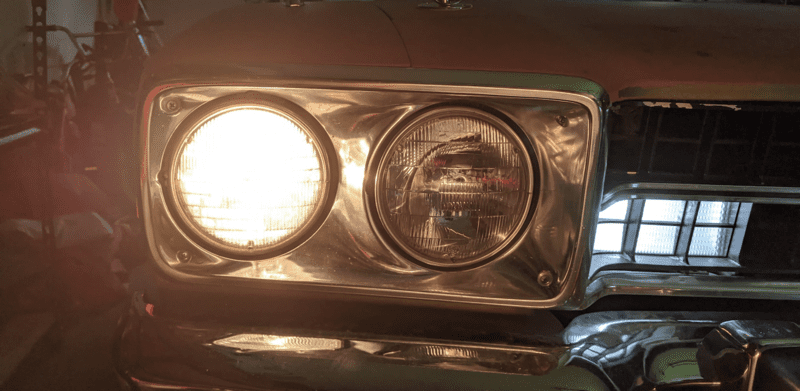

I saw the video now with the new link, thanks. It would be helpful to have a video or picture from the driver's seat view so you can see how effective the lights are down the road. :)
Great idea! I'll take some tonight after it's dark
I've been considering a set of those for my 70 Charger - the lights are hidden so they don't have to look "right" when they're not on. Curious to see driver-seat perspective photos...
