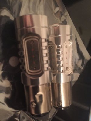

Received the bulbs yesterday. They appear to be relatively well-made though not as heavy as I thought they would be. They arrived packed a little loose in the box and one had a small dent in the base (no problem).
Bottom line guys the bulbs work beautifully, tremendous improvement over stock bulbs, BUT (not unexpectedly) my turn signals would not work at all with them (I also don’t have the front blinker lights connected right now, so that may be compounding the problem). So for now these go back in the glovebox.

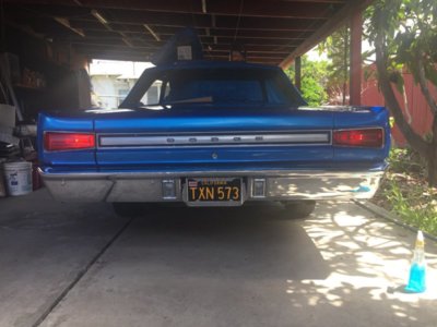

The pictures below show the brake light before and after. The difference between brake light and running light is also very pronounced.
For my particular car, the tail light lenses don’t quite match up, and I have an aftermarket bulb holder on the driver side, yet with the lights on they nearly matched with a nice bold red you see below. (Anybody have an NOS passenger side lens for me?)
